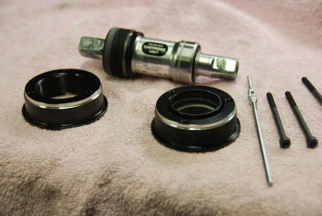

My friend was able to chuck up the adapters today:

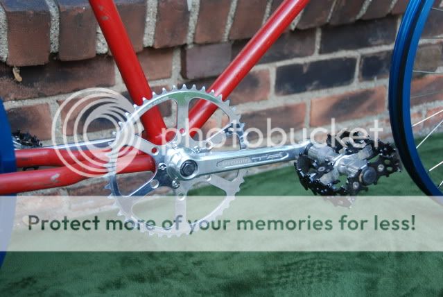

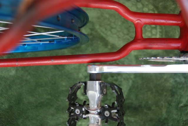

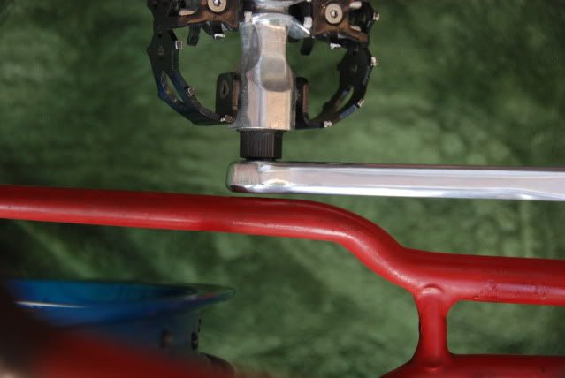

So, I mounted up the cranks to check to see if my old UN71 115mm BB would work. Looks pretty good!
The chainline looks decent too. Not that I could get it any closer anyway...

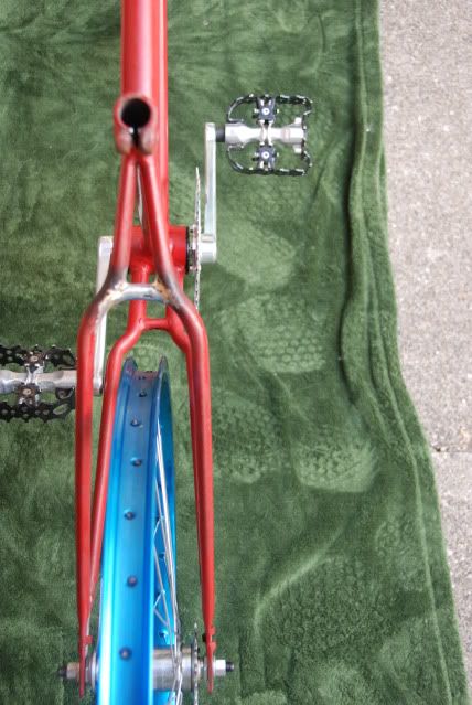

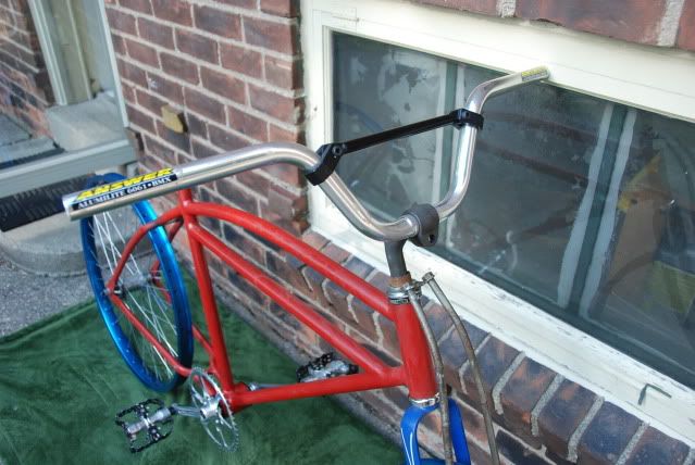

Here's a couple full shots:

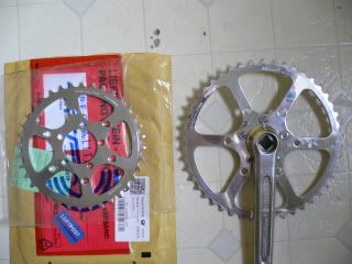

The 36T chainring came from RoBa Bikeparts in Germany. Nice business -- very easy to deal with for an international purchase. The 48T can go on the bay.

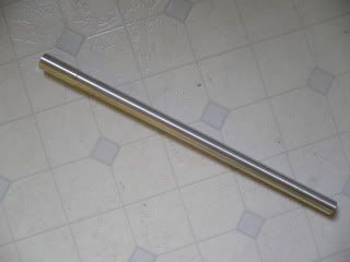

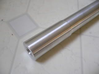

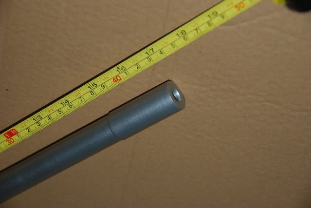

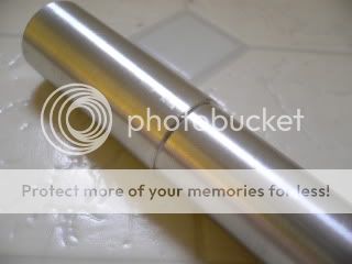

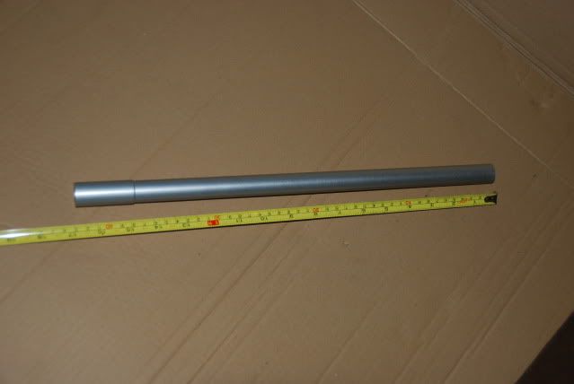

My friend also had time to turn out the 6061 aluminum seatpost. 13/16" with a 7/8" head. It's just under 17" long, so I should have plenty of adjustment. I think I'll get her anodized too.
I had the seatpost anodized silver. Turned out nice!
- 6061, 1" bar stock from mcmaster.com
- 13/16" main section
- 7/8" seat clamp section
- just over 17" long

DM":dckczwfh said:
Crank-arm/ BB/ CS clearance looks quite minimal :D
I'm a little worried about that. It was the the BB size I had laying around.
If the frame seems too flexy once I have her together, I might end up changing out the BB for a longer one before things crash.
I had similar problems.
Long story, involving:
120mm spaced cruiser; Wide chainstays for tyre clearance; screw-on freewheel with non-adjustable chain-line; US>Euro BB adapter cups; random crank/BB taper interface... and a crank that I REALLY wanted to fit... but couldn't.
A total lottery getting the random parts to work together, but all good fun! :D
