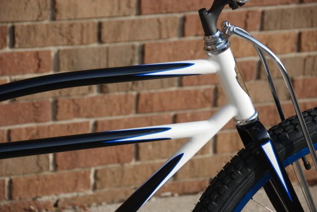

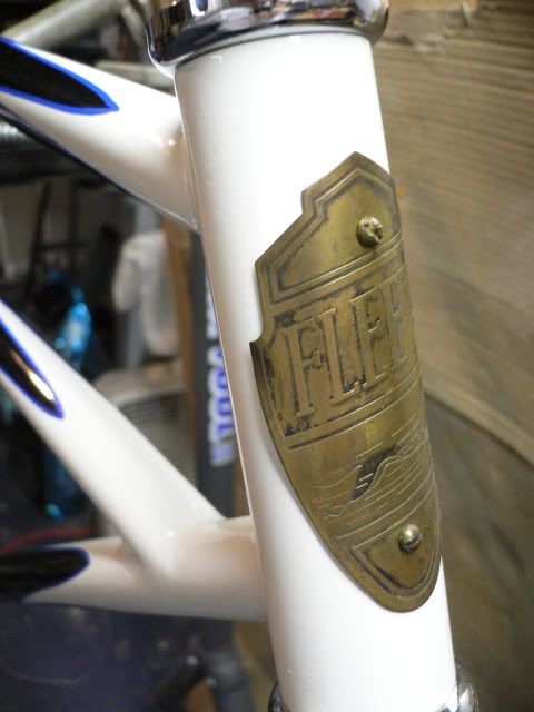

First -- on with the headbadge:

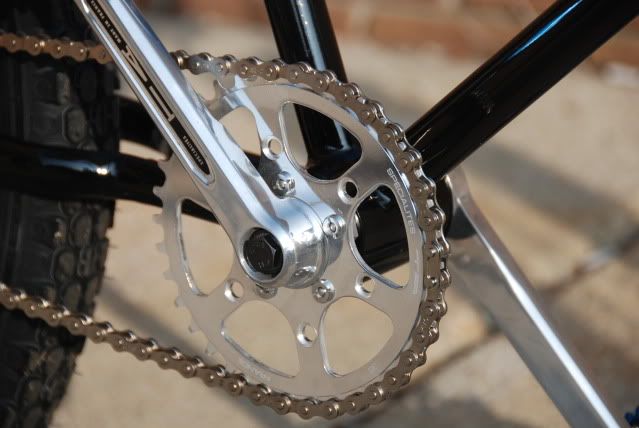

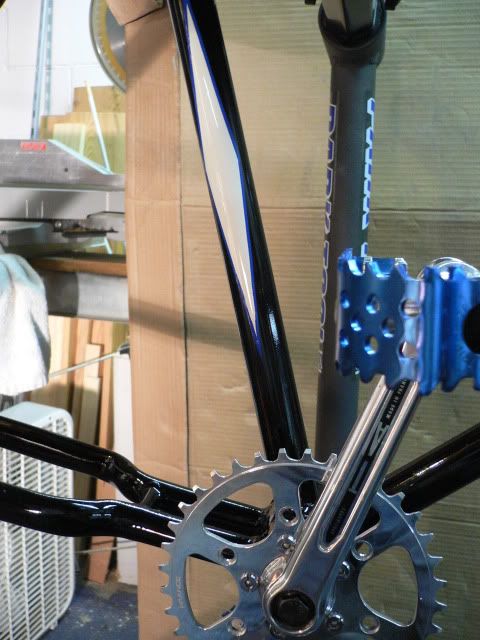

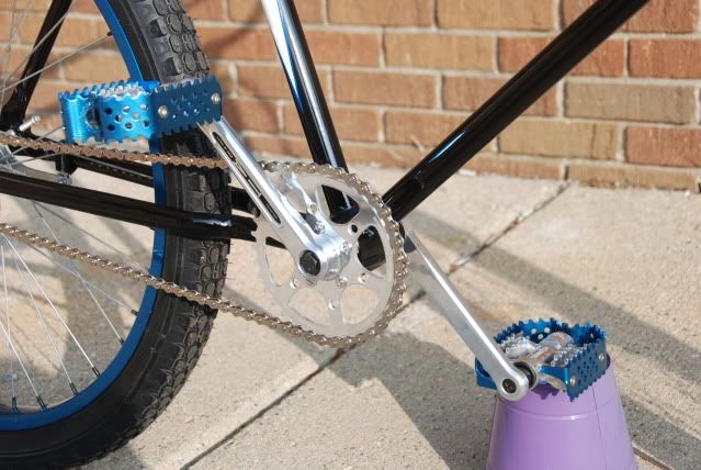

Cranks next (little worried about the arms touching the chain stays under load -- note to self: put some masking tape on the chainstays before you ride):

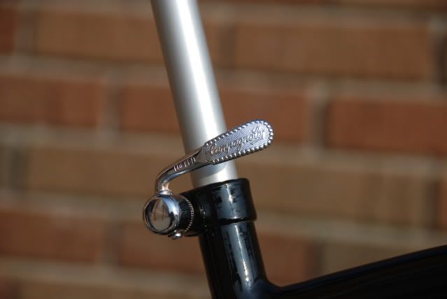

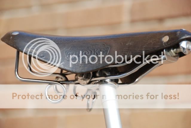

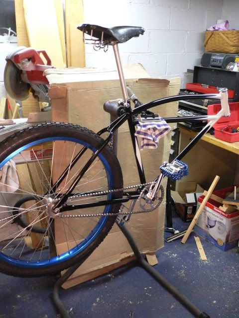

Chain, rear wheel and seat post:

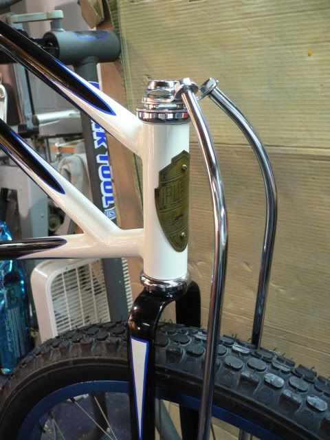

Fork, truss rods and front wheel:
Stem and bars:
Almost done!

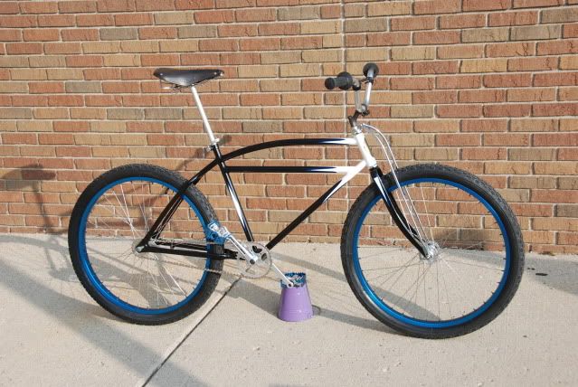

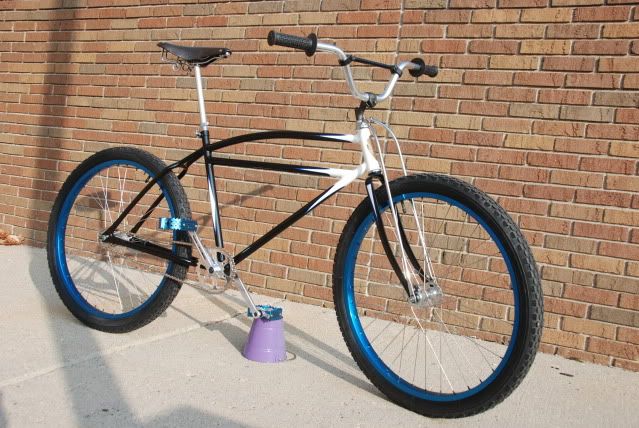

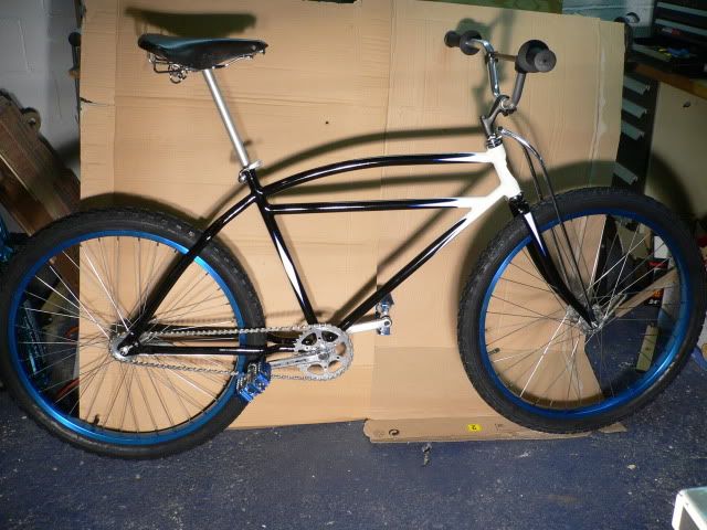

Finished up the last of the details and took her for a spin. All systems go so far.
Frame: 1936-38 Fleet (Schwinn) C-Model
Fork: 1950's NOS Schwinn Forged w/ 1938 Schwinn Motorbike truss rods (rechromed)
Headset: NOS Tioga MX-2
Stem: Astabula 1976
Handlebar: Answer Alumilite 6061
Grips: AME Tri grips
Cranks: TA Pro 5 Vis (60th Anniversary)
Chain: KMC BMX Z410 Silver
Bottom Bracket: TruVativ American-to-Euro Conversion kit + Shimano UN-71 68x115
Pedals: Odyssey Triple Trap (NOS)
Rims: Ukai 26x2.125 NOS blue anodized
Hubs: Rear: NOS 1980's Suntour coaster (came laced to the Ukai),
..........Front: NOS Shimano 333
Tires: Cheng Shin C693
Saddle: Brooks B-72 (1985)
Seatpost: Custom turned 6061 Anodized
Seatpost Binder: Campy
Weight: 33 lb

Just one thing- tilt the bars back a few degrees. They always look nicer with them raked back a touch.
