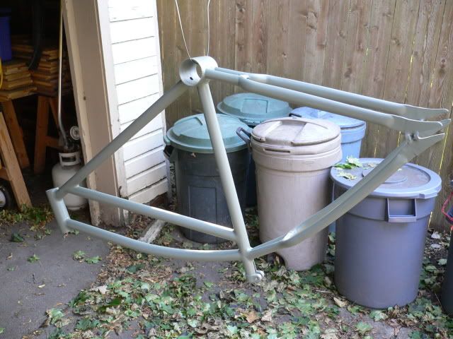

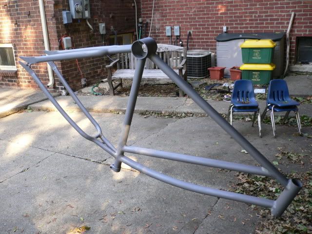

Frame and fork back from the sand blaster.
Emptied a can of self-etching primer on it. Still need to fill a couple divots, do some sanding, and spray with some white primer. If the weather holds, my friend is going to squirt on some single stage urethane in Austin Healey Old English White and Black on Oct 18th

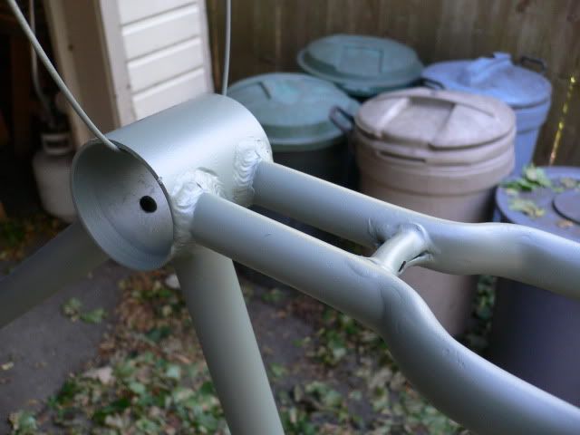

The priming and sanding are coming along. Hopefully the weather will be good enough next weekend!

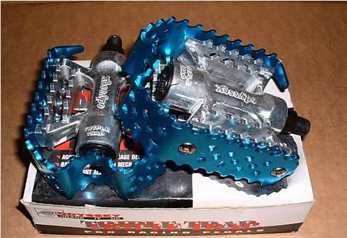

NOS Odyssey Triple Traps (in blue to match the Ukais - I know they are a bit too new for a klunker, but I couldn't resist the blue ano and I like a big pedal platform anyway):

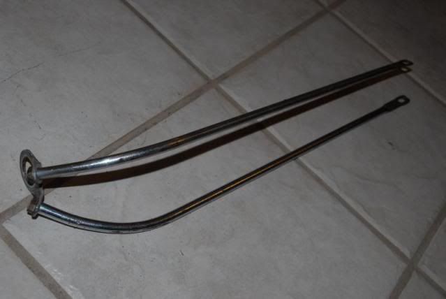

1938 Motorbike Truss Rods (my other pair were a bit wavy and I had to put a twist in one to make it fit... these are much nicer!)

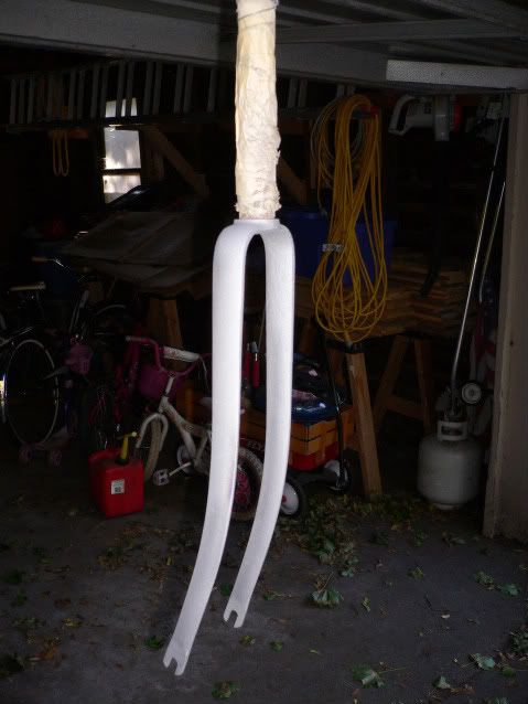

Three spray cans of white primer later and a final sanding with a scotch-brite pad, I think we're ready for paint this weekend.
That was the first time I've used a scotch-brite on automotive primer -- it really works great and kept me from cutting through like I usually do with wet-or-dry sandpaper.

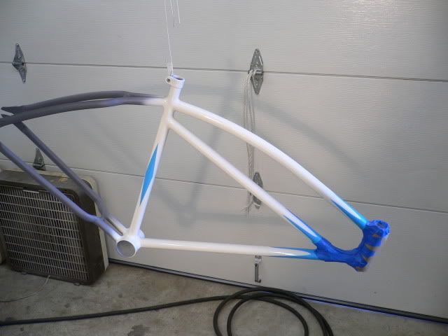

Good news it that we had a couple warm days here in Michigan and we got the paint on!

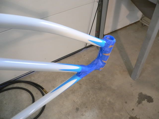

Single Stage Urethane,
Jet Black & Ford Cortina Old English White

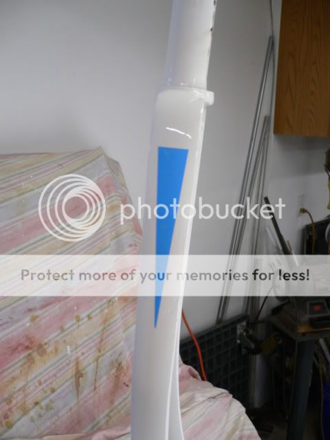

One coat of Acrylic Sealer, 3 coats of white, 24h of drying and the stencils applied

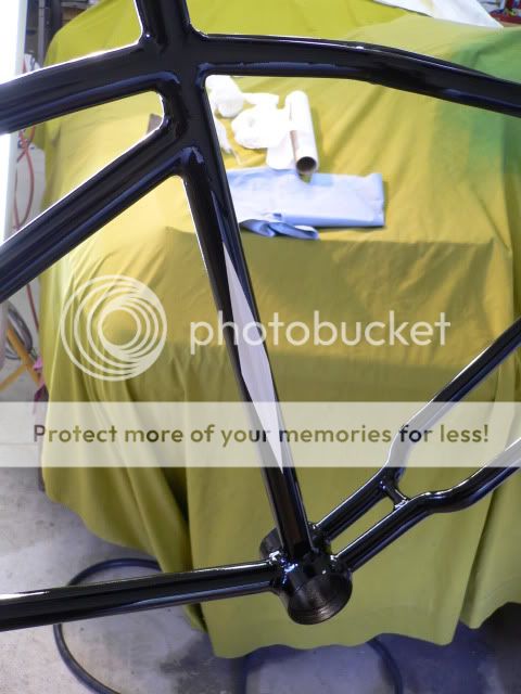

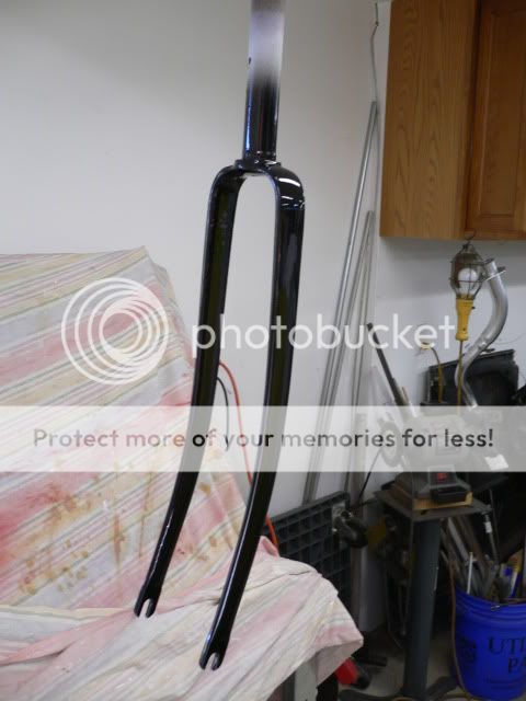

Two coats of black
45 minutes of drying and the stencils removed
I'll sand/smooth the edges and polish it in a few weeks, then wait to spring to have it pin striped blue.
I know... hurry up and wait, but this urethane takes a long time to fully cure and fully shrink. I'm not going to ride in winter anyway.
Looking fantastic J. Where did you get the stencils for the darts?
