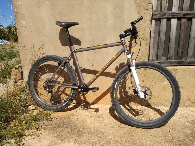

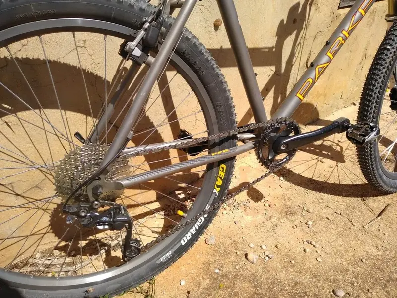

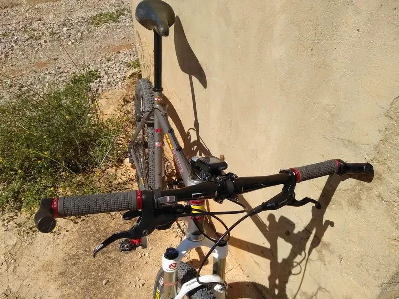

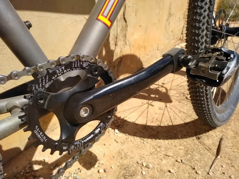

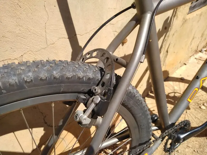

Here's mine - 1995 Parkpre pro elite with a modernish reba fork, 1x10 gears with a mix of xt and deore. Chainset is an XT M750 square taper, painted black to match. More modern hope hubs (pro 2, I think). chainring is a 32t NW, cassette is 12-36. Don't need anything lower than that, it I do it's faster to get off and walk. Setting up takes a little longer, and I'm not completely happy with the chainline (big-big makes a bit of noise), but I like it.
