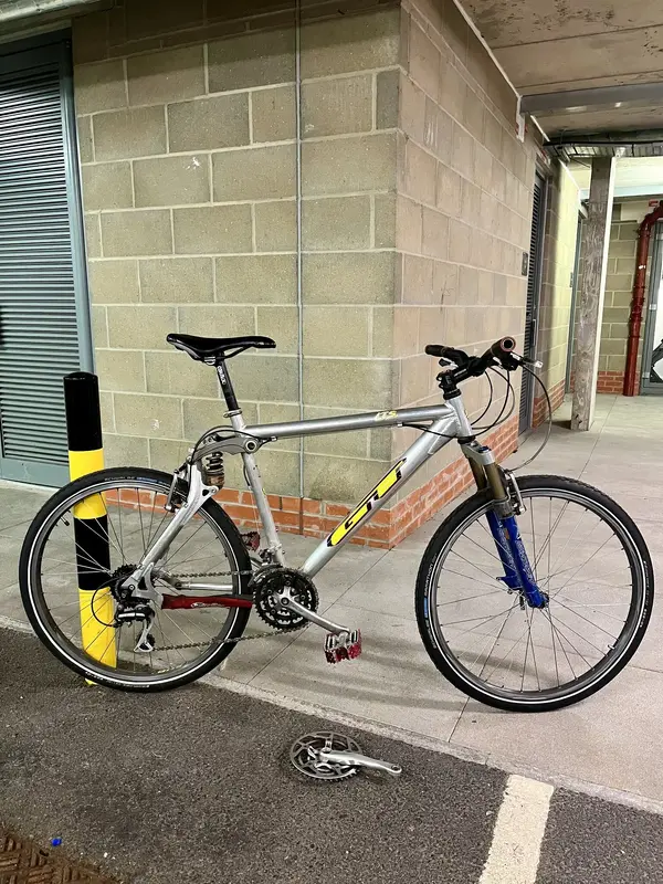

So - the bike had been knocking around at the back of said LBS for a few months gathering dust and I couldn’t help but peek through the window and say ā€˜should I?’ I eventually said I should!
Here is the first photo from outside the shop:
As you can see it’s had a hard life but from my light knowledge of retro MTB, I spotted some choice parts and made a deal with the gaffer. A solid 80 quid well spent! (I think)
Here’s some more photos from when I picked it up. LOOK at those rings šŸ˜‚

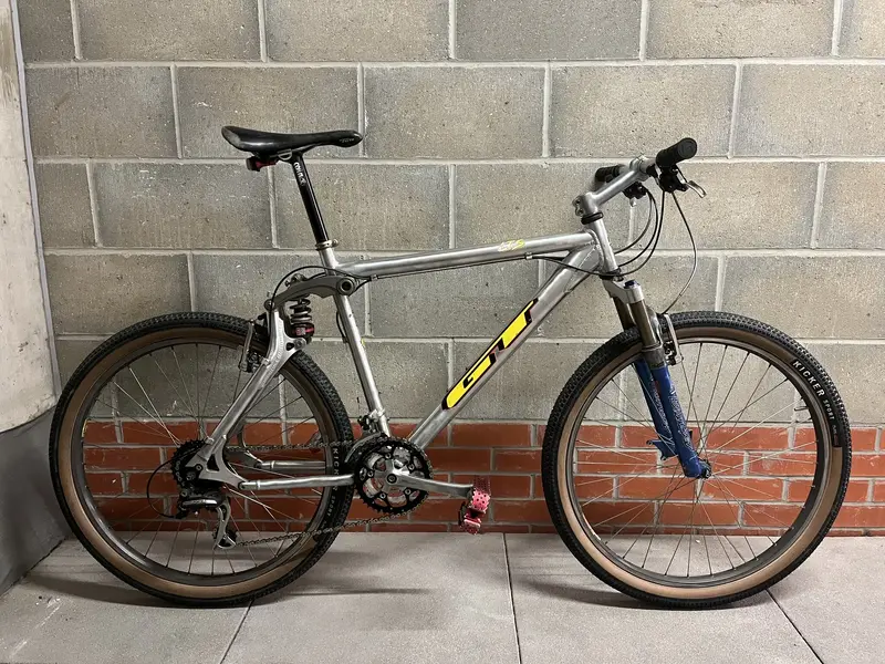

So, first things on my agenda were:
- Clean the frame
- Change the cockpit
- Get some fast rolling tan walled tyres
- Chainrings
- BRAKE PADS!!
Disclaimer - before I offend anyone here. The bike will not be exactly period correct, however it’s definitely an ode to the period in my eyes and in the old man’s honour 😁
The bike is going to be used for cruising around London, and there is potential for me to do the odd XC ride here and there in the future..

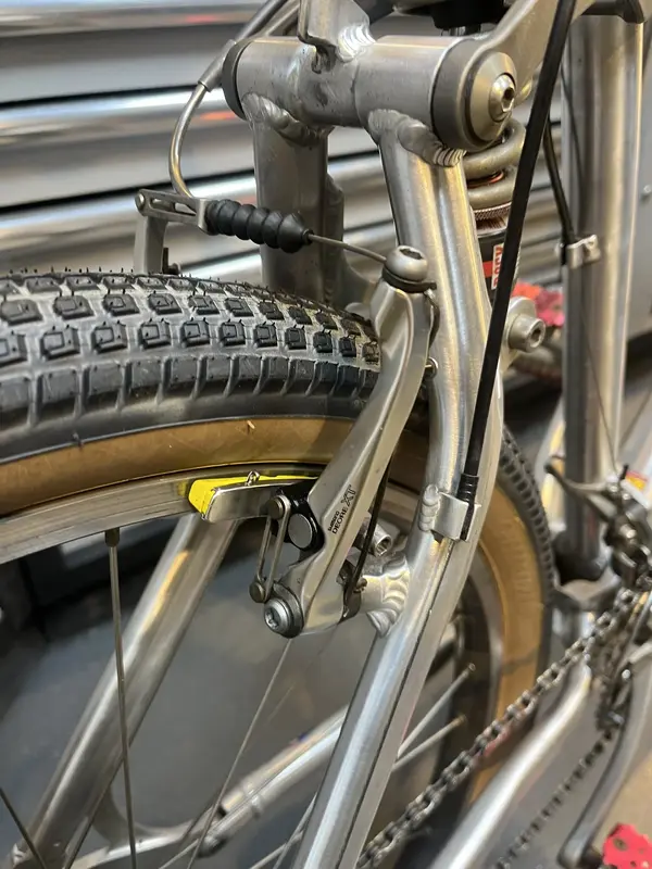

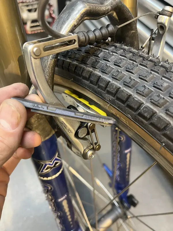

The old Kool Stop blues have been replaced with some Yellow’s. Picked yellow on the basis that they look cool.

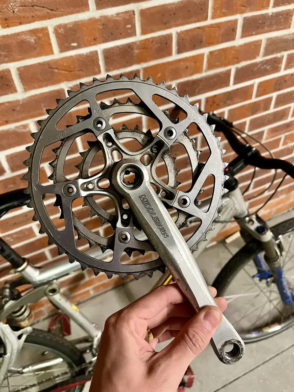

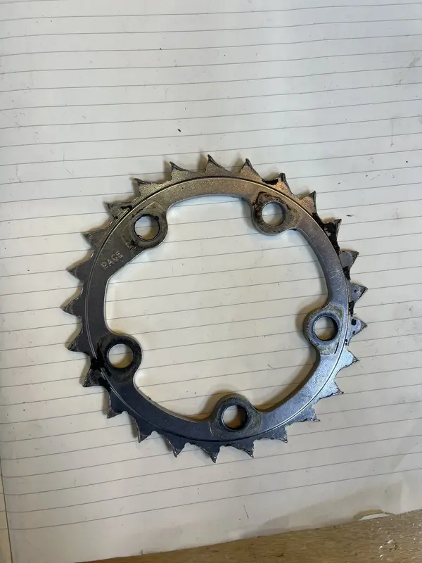

So, @Paul R will be happy to know I got the Middleburn crank cleaned up and ready with some new rings thanks to @KermitGKona88 - wonderful seller thank you for the fast delivery.
Out with the old:
In with the new:
And voila’ 🤩 does anyone have a recommendation for nice crank bolts instead of the cheap plastic looking ones?

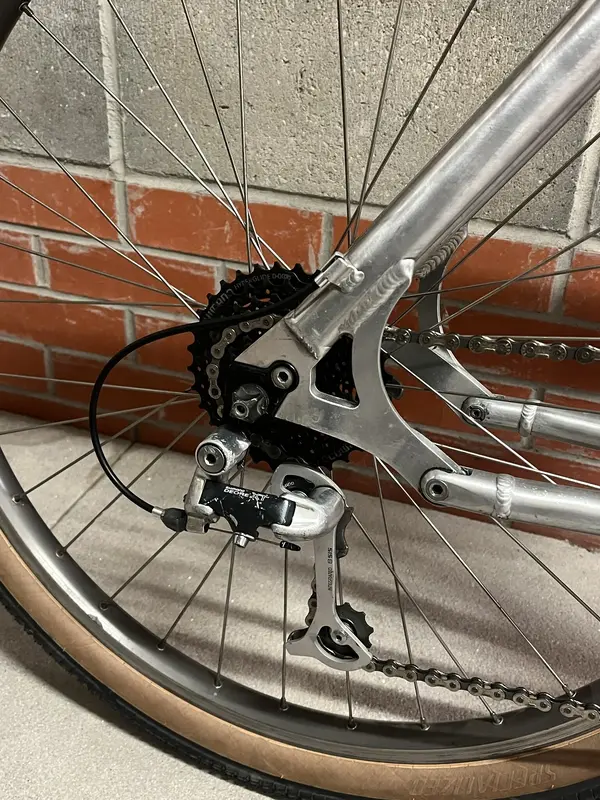

I also took the liberty of putting the Acera rear derailleur where it belongs (bin) - and installed a cheap eBay find Deore XT to match the rest of the group. Not mint by any stretch of the imagination but at least I can now sleep at night knowing it’s not Acera.

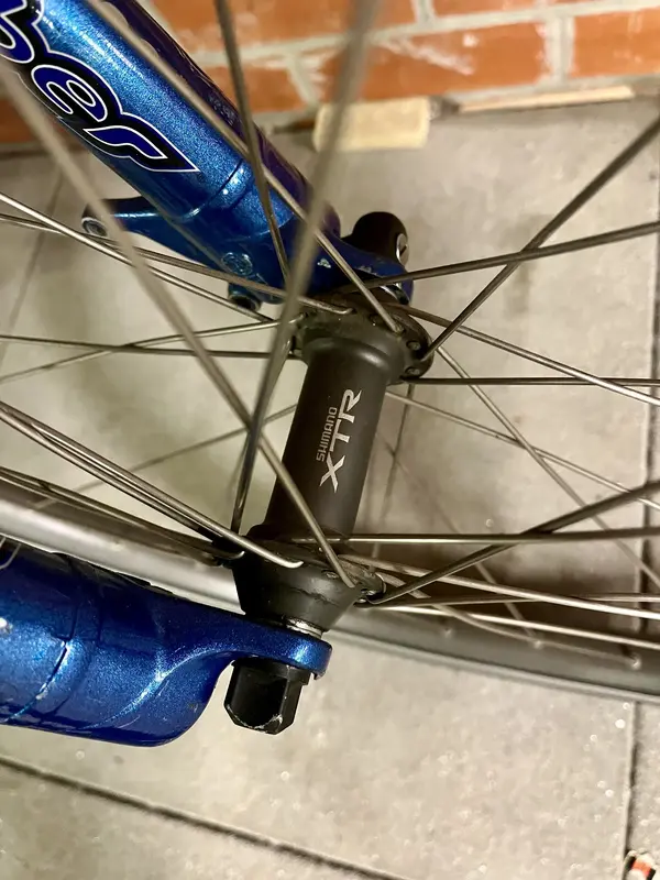

I’ve gotten a little bit carried away here (kind of out of necessity which I’ll keep telling myself).. the WTB headset on the bike was completely shot. It either rattled, or the steering was near locked. So I searched for a headset and ended up striking a deal on eBay for a red CK. I’ve seen countless bikes on here with really cool anodised components and I want in.
I also didn’t like the fact that the Bomber fork on the bike was too new for it, so in RB spirit I looked around for a 90s bomber rather than the ā€˜Atom Z2 Bomber’ one that was on it. I’ve ended up with an insane ā€˜Superfly’ which is a few hundred grams lighter!

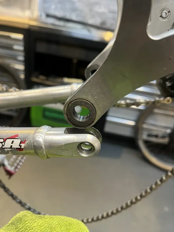

- And the most important thing (which I’ve been avoiding clearly), the bike creaks like no tomorrow when riding. I assume it’s the bushes(ings?) which are making noise? Where can I find and how do I replace these?
I did open up the chainstay from the dropouts and it was super dirty. I gave it a clean and fresh grease in what I presume was the ā€˜friction’ area and actually made the problem worse.
Help!
I canĀ“t help you with your suspension woes (is it really the suspension that creaks?), but I can tell you that you can easily use the old chainring in your circular saw šŸ˜‚
