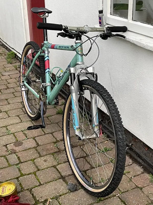

Thoughts pls - is suspension travel too long?
my original comment was based on 75mm to 100mm. if it is as indicated by joglo that it originally had 63mm then yes, that's a bit much especially as the judy SL was a really short ATC fork designed for XC at the time.
Thanks - I guess a 65mm fork would be ideal

Looks like the finish matches the Bianchi sticker on the seat tube too.
Indeed, also the silver base color fit to some parts of the bike, just a bit red is missing in the front. What about plotting red "QUAKE" decals in original size to add them as overlay?
