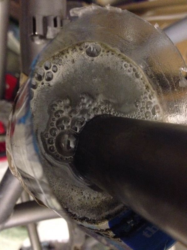

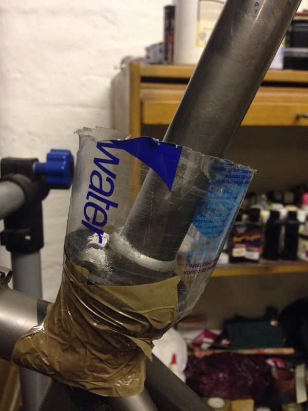

I gave it one last go after trying penetrationg oil and brute force. I filled up the vessel with caustic soda and let it bubble away hoping that it would eat through some of the alu shim to get the seatpost moving. I let it work for a couple of hours drained it out and then attached a metal rod to the end of the seatpost clamp to try to get better leverage. I wedged the metal bar between to big static sturdy pipes to act as a clamp (my studio is in an old mill that was run on steam so all the old massive pipework is still in place).
AND...... nothing.
so off to the framebuilders it is.

Should have cut the seatpost and sealed bottom bracket and any holes in seat stays, headtube etc. That caustic soda mix looks far too week and two hours not long enough.
^^^ as above
I would have done it that way feeding from BB.

Just checked on mine, and because of this 80mm shell/shim there are no holes going into the stays or top tube.. plugg the seatpost turn it upside down and have a go :)
