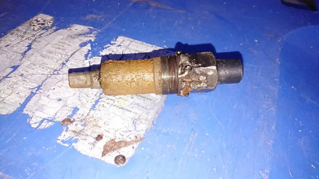

I had to resort to welding a park bb tool to the bottom bracket trying to remove a very very stuck BB from my 2004 Kona explosif recently, I'd initially bolted the tool in but managed to strip the teeth twisting the frame with the tool in a vice. Even after getting it all red hot it still took all my strength to turn the thing, luckily the frame threads have survived.
Brutal but it was my last resort.
