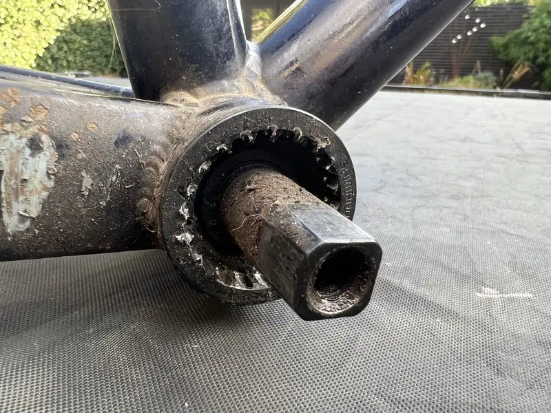

I have Shimano cartridge BB that is currently stuck in the frame.
I’m looking for any tips to try and free it please.
Problems that I have are as follows:

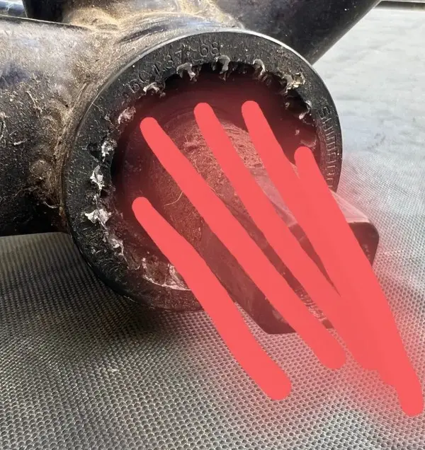

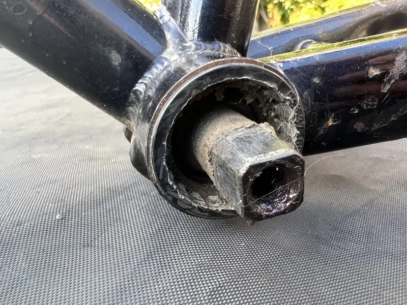

1) the plastic, non-drive side cup became brittle and all of its teeth ripped off at the first time of trying to remove it…so there is nothing for the correct tool to attach to anymore…
2) the metal, drive side cup has intact teeth, but a tool has slipped once in trying to remove it, so the teeth don’t look so healthy…
Before I bolt the tool in place on the drive side and try leverage, anyone got any suggestions? I’m concerned the tool is going to slip if I lever it from as far away as possible, which will reduce my options further.

Remove the driveside and then if worse comes to worse you can melt the plastic one out/ cut with a junior blade but likely it will come out without that method.

I had considered trying to cut out a section of the plastic cup so that I could tap it around and out - allowing me to lubricate the drive side cup from the inside. Madness?

If the drive side is really, really stuck fast ( to the point of the teeth breaking) then one option is to hammer the spindle out through the non drive side. The remnants of the plastic cup will break before the steel. You then have room to get a hacksaw blade in and you can then cut the drive side cup very carefully in 3 or 4 places and it should peel out.
Caustic soda will dissolve it too but its nasty stuff.
