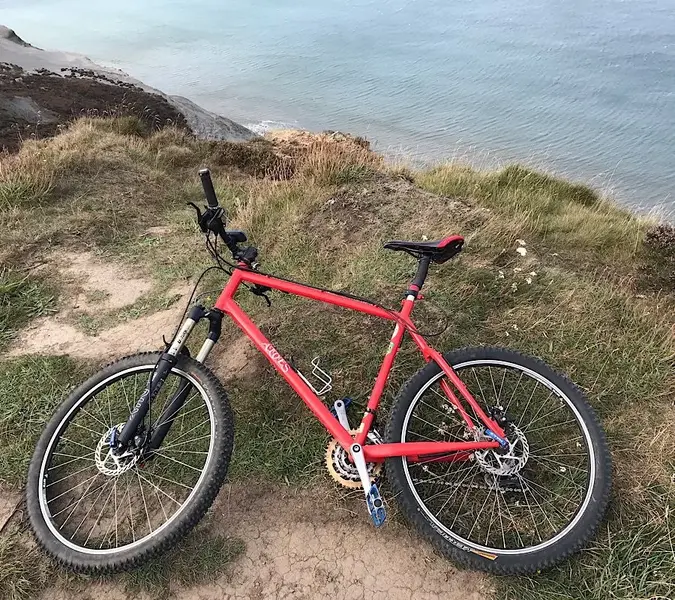

I have a 93 filled brazed Alves that went back to Charlie for a disc conversion. No extra seat/chain stay brace. I’m running cable discs as my regular rider. Modern forks and a mixture of bits. Very similar ride to a top Kona but bettererer.
