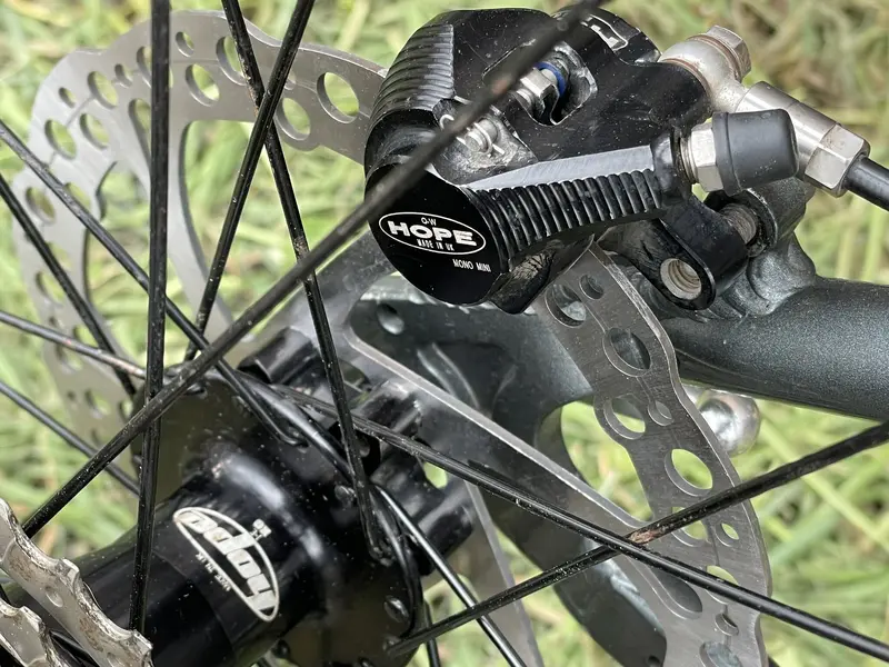

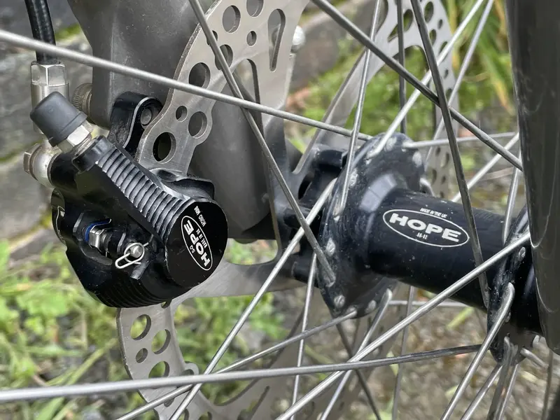

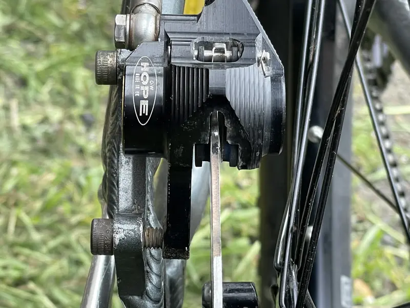

Thought I’d do a simple Hope disc swap on my 99 Kona Chute today. The frame has IS disc tabs and the Judy XLC also has IS mounts.
I had a set of Hope Mono Mini brakes spares with both calipers marked as 3. This should have given me a front disc size of 185mm and rear as 165mm according to the table I found through a search on here.
They’re fitted to a set of Hope XC hubs.
I managed to find the correct spec discs (185/165mm) through my LBS

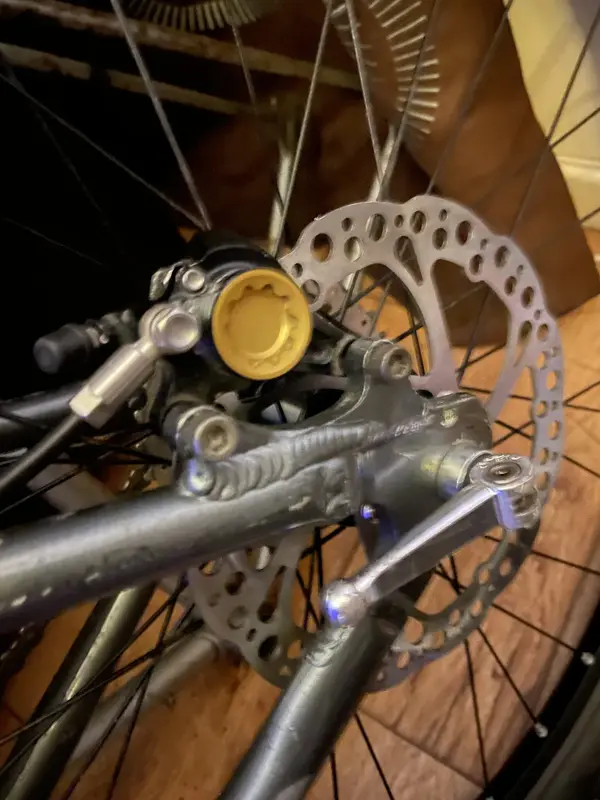

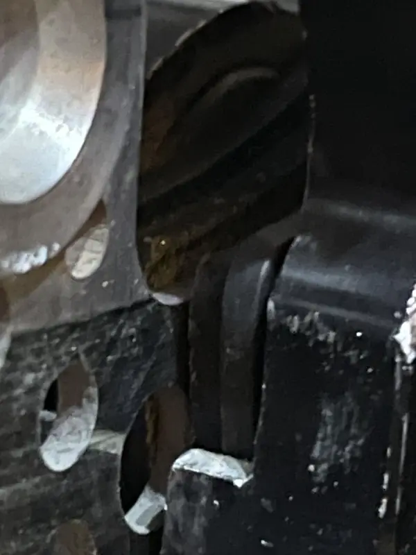

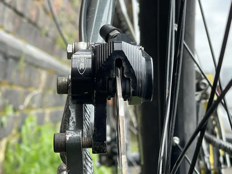

All was going well until I fitted the wheels 😅 The front disc scrapes against the caliper where as the rear disc seems to be around 5 to 10mm too small. I realised I need to space out the rear caliper too around 5mm as it won’t bolt flush to the frame.
Question - has anyone done this swap here? Does anyone have a suggestion for the rear?
The front should be an easy fix just chucking on a 180mm disc but the rear is confusing me.

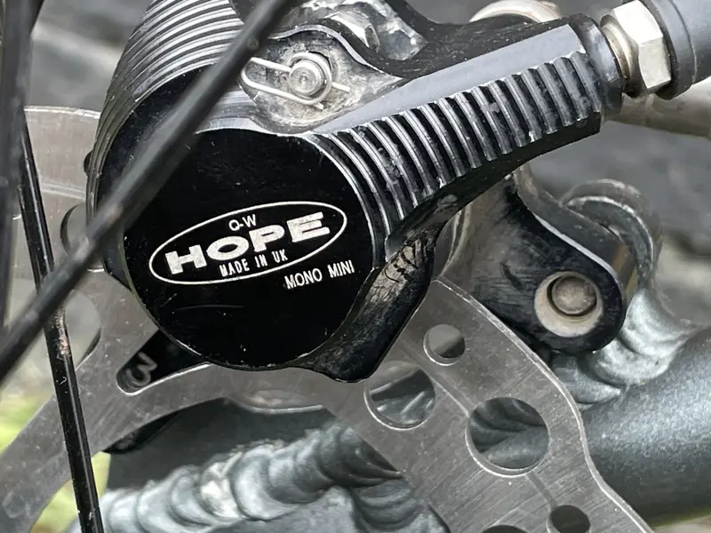

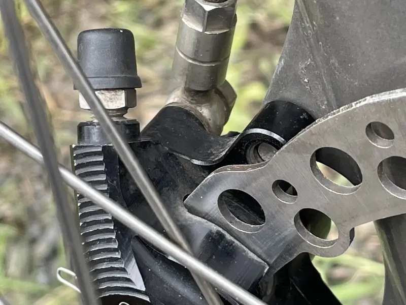

Never mind.
Trialed a 180mm rotor front and rear and it looks like a 175mm might give the best fit

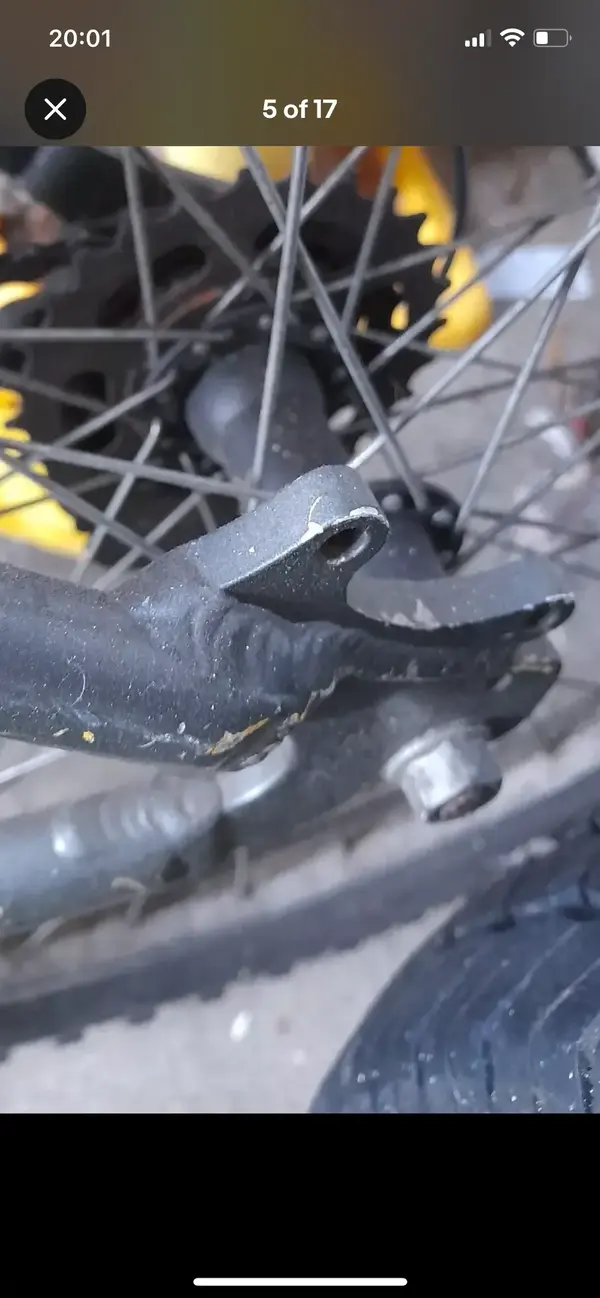

It also looks like my IS mount on the rear could be backwards 😅 Comparing it to another Chute I’ve found on eBay… the straight part of mine is at the bottom near the dropout where as on the other frame it’s at the top 🤷‍♂️

Sadly your problem is that the is mounting holes are in the wrong p

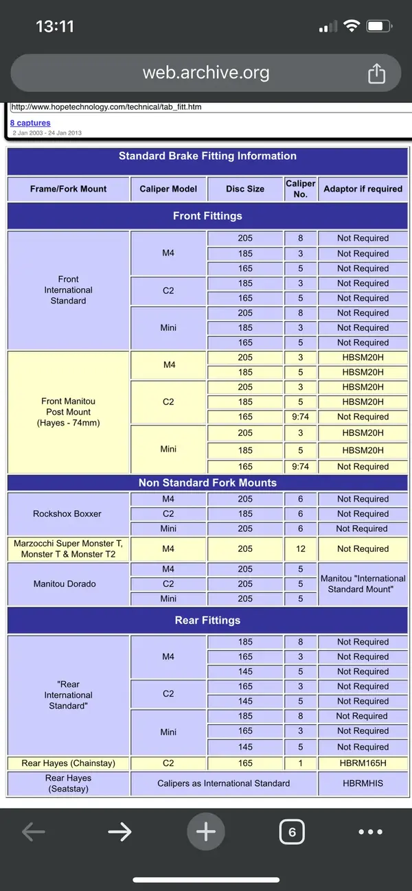

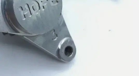

As I've only dealt with Hope brakes upto the Mini I thought your numbers were wrong, so with a quick search the plot thickens,

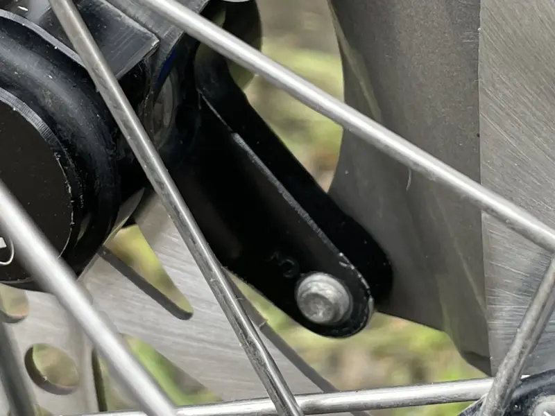

Almost looks like the mount was an afterthought as discs were gaining in popularity around that time. My 2000/01 Kona Roast has integrated disc mounts into the dropout and I have Mono Minis which fit without an issue.
Hope you can work out a solution.
I hadn't thought that the caliper itself might be non-IS, I was thinking it was the mounting tab.
The earlier hope brakes came in a variety of options, with numbers etched in to the caliper.
20240401_091808.jpg Iirc the eye to eye distance was usually different. I was also thinking that by the time of the mono mini, it had all become much more standard.
We also have a box of hope caliper halves, but I think they are mostly the splittable minis before the monos
Oh ok interesting.

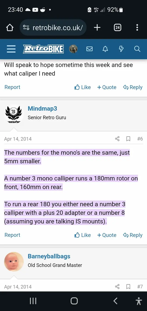

I found this thread giving these links
Post in thread 'Hope caliper numbers help'
https://www.retrobike.co.uk/threads/hope-caliper-numbers-help.220444/post-1662700
It linked to this table.
Both my calipers are definitely 3 but yeah if that the one you found is accurate 5mm smaller would work on the front. Might be why the set came with 180/160mm discs 😂
Just bad luck I guess that the rear disc tabs are welded on the wrong way round
There’s my caliper numbers. Both 3 🤙
