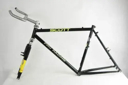

OK! This is an XC, yes, and it looked pretty beat to shit when I opened it. Elastomer dust...
I'm also interested in knowing what kind of specifications/dimensions I need in my search for suspension OR rigid fork, as I'm kinda new to all this.
I imagine that there's more to it than I assume.
Bike feels so good to ride, so I really hope I can find what I need quickly and get it back on the trails.

You need an unthreaded 1 1/8 steerer fork. These XC pop up from time to time on ebay or here on Retrobike for decent prices. You'll just have to measure the length of the steerer tube.

Do I need to remove the current fork for that, or can it be done (by estimate) without removing?
In new fork: Look for 1 1/8" threadless, same size as current fork (or longer and cut), and similar width (wheel clearance) - what about "travel"?
Any other parameters I should be aware of?
Nobody I've asked yet thinks that a non-suspension fork is a good idea, so I guess I don't need to ask about rake... haven't been able to find a suitable one yet anyway (am looking for a Scott fork of similar vintage, or else maybe a Kona p2 if that would work...).

As far as I remember, this one came in rigid and suspension version, but I don 't know if there is a difference in frame angles.
Best thing is to remove the current forks so you can measure the steerer tube. But first check condition of the headset; when a new one is needed, it's stack height will be decisive for steerer tube length.
Maybe ask help from someone who has done this before. ;)

Thanks! I've managed to get the fork off, and the headset has been inspected by a more experienced friend - looks good.
The steerer tube measures 170 mm - any suggestions / recommendations on forks that would look/work well on this bike?
