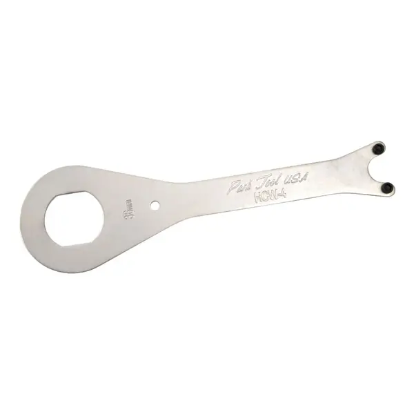

Your threaded rod plan should be just fine, I always screw in the non-drive side cup until a couple threads are sticking out (your rod should still fit through the hole and will keep things straight and your other washer off the frame)
Use a proper BB wrench, not a headset wrench (see pic)

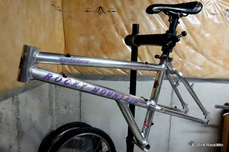

after letting it soak for about week and a half or two in liquid wrench, i still couldn't manage to get the drive side fixed cup to budge. so late last week i took some time and went by a local shop to see if they could help. after quite a struggle, they finally managed to extract the cup… YEAH!!! :D
so here are the two bare frames side by side. the black decal one is now on it's way to it's new home. i started to refinish the frame with rubbing compound to remove the corrossion and heavy oxidation in areas. you can see the after effect on the chain stays compared to the down tube. i'm not looking to polish this up perfect, just tidy it up a little so it's more presentable in a used but clean state.

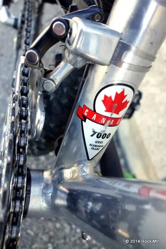

with a lot of elbow grease, finally cleaned up the frame to what i'm happy to leave it at. did this over a few days here and there. still lots of patina on it. a few rough spots were there was some corrosion which i couldn't completely clean off without probably some heavy sanding. also a few nicks here and there, with one somewhat deep one on the top tube. much more than the prev frame although i'm still happier with this one, as the other had some more serious flaws on it.

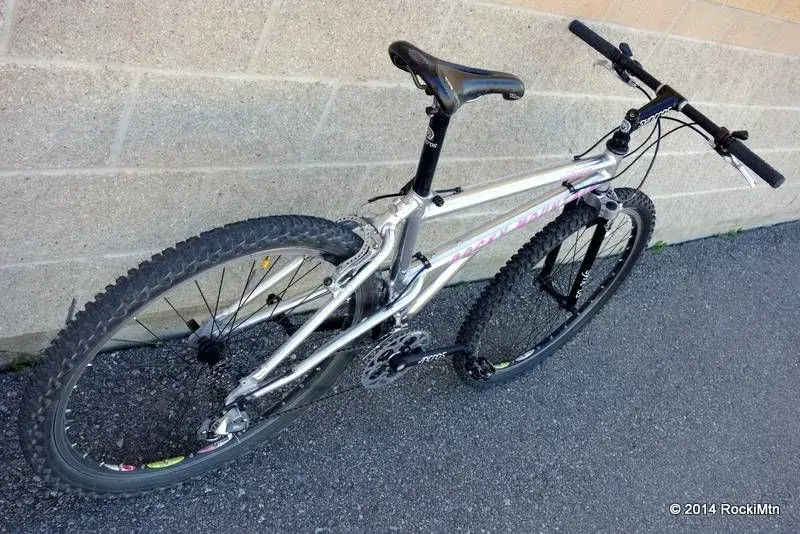

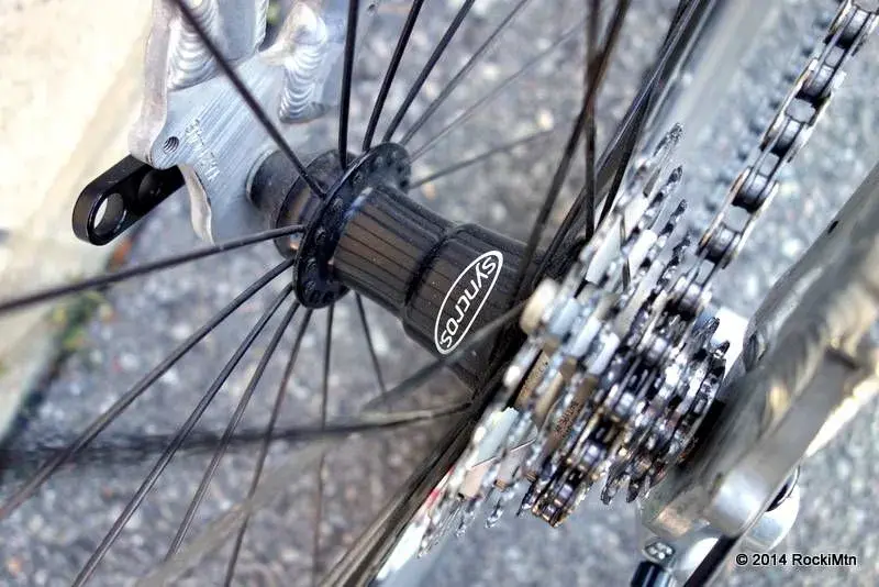

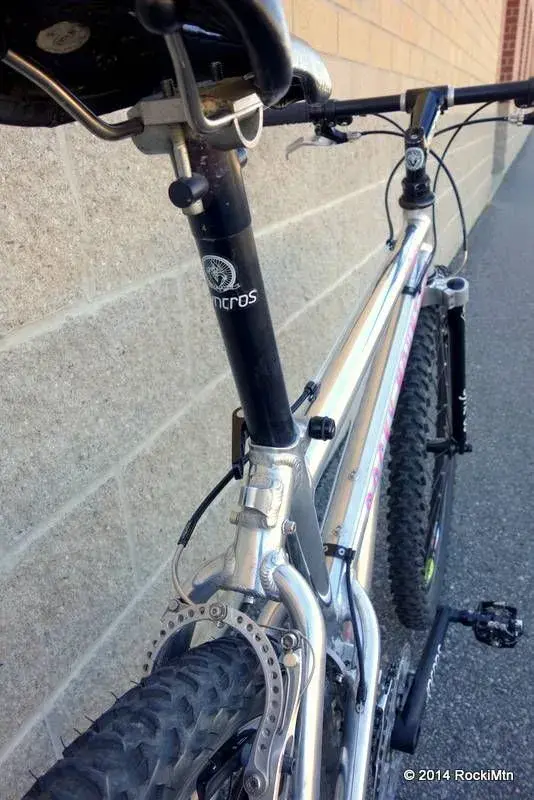

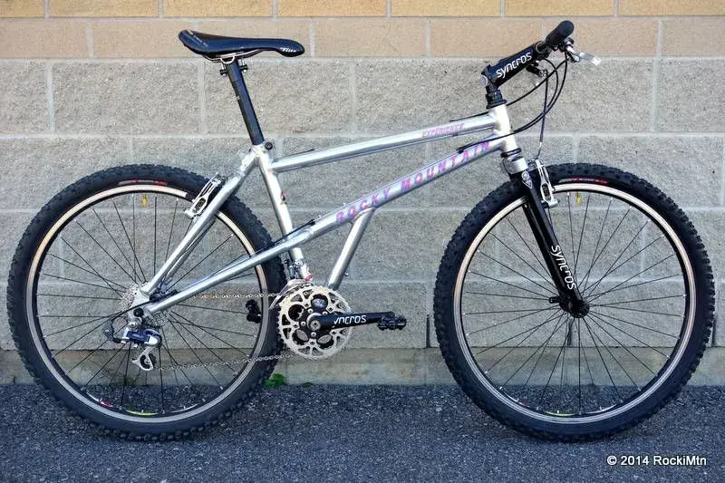

so finally rebuilt the Experience up. didn't receive any feedback so i gave the Revolutions a go. i think they look better, though it could be the fact that i have a different colour pattern for the rings with silver/black/silver instead of the black/silver/black.
again i had to up the axle length from the recommended 117mm axle to 122.5mm, as the FD would rub the nobs on the tyres. luckily i still had the original ti axle that i had swapped out for 113mm to fix the same issue with the Forged cranks.
so this is the final build for this aside from maybe trying the Forged cranks again with the silver/black/silver ring setup. only thing required now is for me to get on to getting black decals done. original magenta decals will stay on until then.

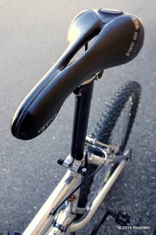

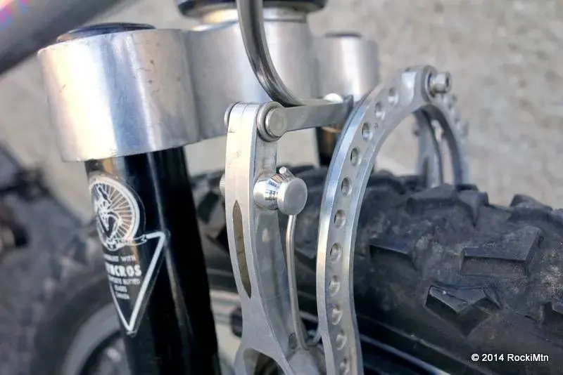

would like to showcase and thank B3 who helped make me some replacement spring stops for my Avid Arch Supreme brakes. had broken one of the original plastic ones, and these alloy ones are much better! :cool:
also here are some more close-up shots.
