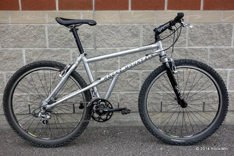

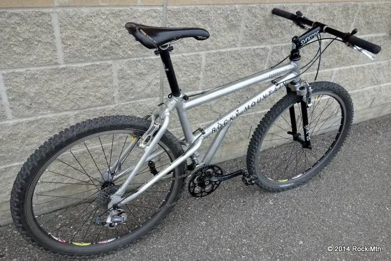

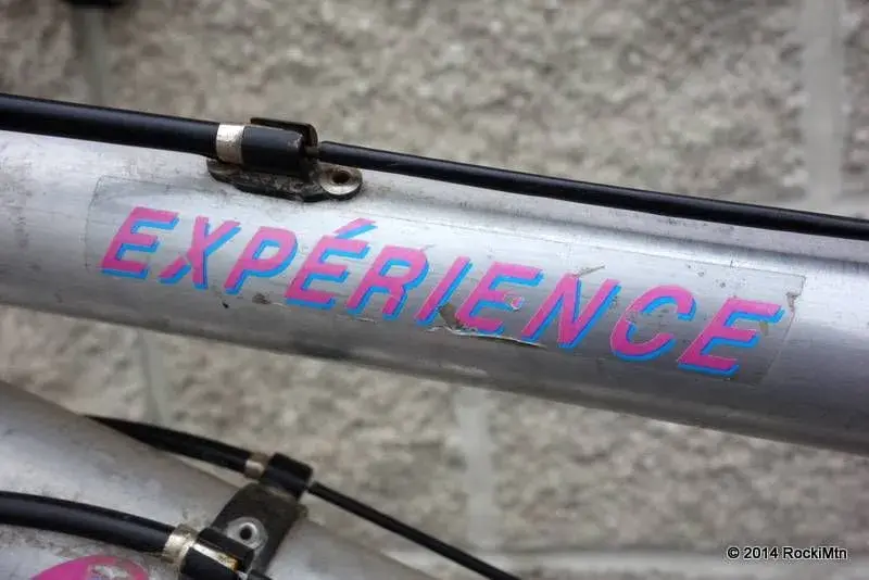

i've done a few updates so thought I'd share. since i had them, i finally applied the decals to the frame. i also had to swap out the ti Syncros BB axle for a longer one and adjust and push out the chainline as the front derailleur cage was rubbing against the nubs still back tyre.

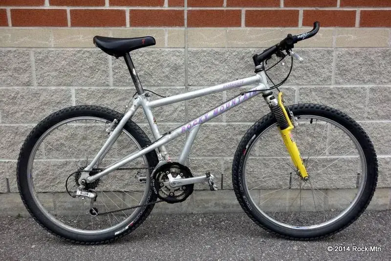

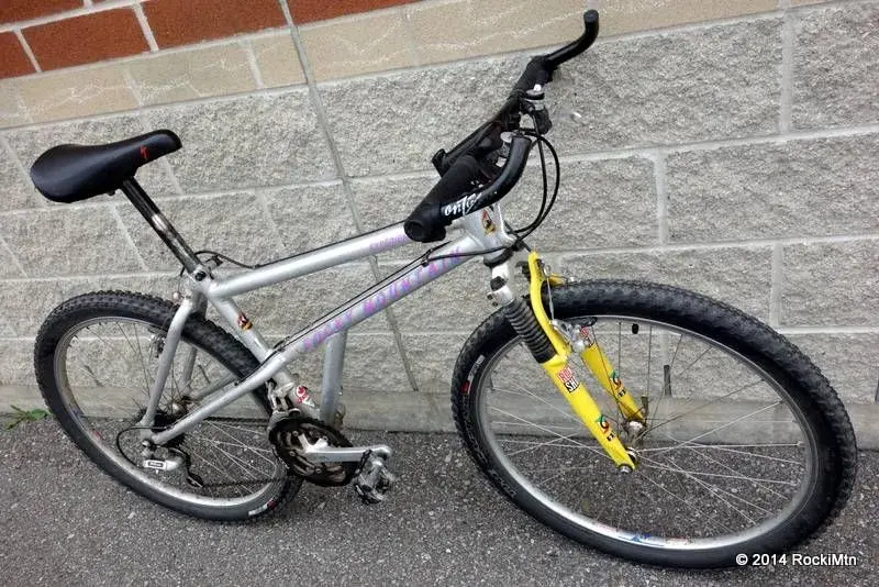

now the more exciting update (for me at least). i've managed to finally get my hands on a better condition frame. :D it's almost original except for the saddle, tyres, pedals and front fork. full DX groupset, original RM house brand wheeltech built DX on Wolber AT20, RM branded bar, stem and seatpost, Rock-Ring, and most importantly… original decals! :)

The black decals look great with all the Syncros parts. Very nice!
What's the plan with the original build / pink decal bike? A matching pink Tange fork? Or another Syncros powerlite?
Re: Rocky Mountain "Syncros" Expérience
my plans are to take all the Syncros & parts and shift them all over to the lilac/lavender frame and move on the black frame to someone else to enjoy. from there i'll decide if i can leave the original decals on it, or if not, then i'll get black/white decals re-made for it.

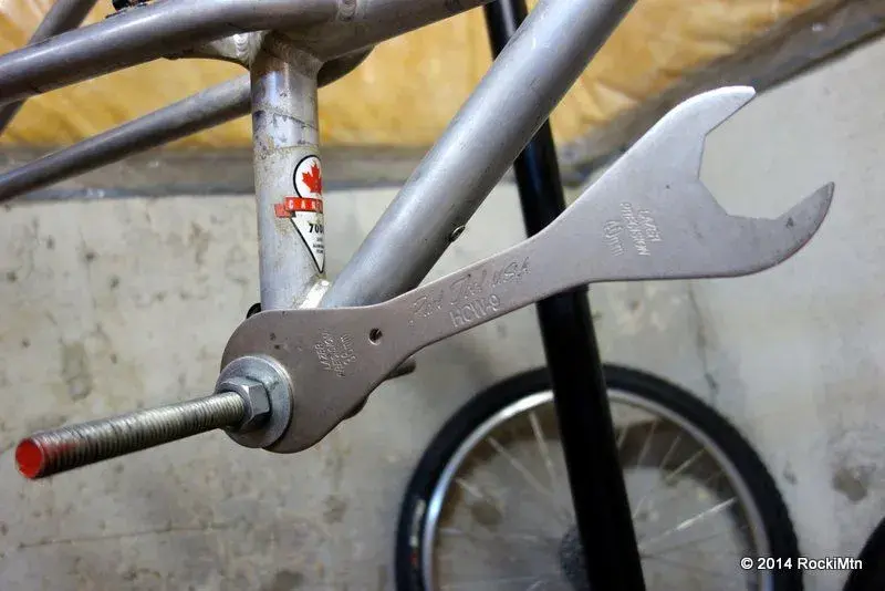

so tearing down the lilac frame was a fairly quick and easy affair till i got to the last step of extracting the BB. non-drive side lock ring and cup was no issues. however the drive side fixed cup was another matter. haven't been able to budge it whatsoever. doesn't help that all i have is a double sided headset wrench that i can't get much leverage on. i tried keeping the wrench from slipping off the cup with a rod, bolts and some washers and smacking the wrench with a mallet… no luck.
then i did some searching and read this post in the following thread and i thought it might do the trick to allow me to get more leverage onto the BB cup: viewtopic.php?f=1&t=298759&start=5
went to the hardware store and picked up a short bolt, washer and nut and tried to secure it to the bb cup to see if i could use some sockets to allow me to use a long torque wrench. however i couldn't secure the bolt/washers tight enough to lock to the cup, but instead the bolt still spun in place instead of taking the cup with it in it's rotation. needless to say the hole for the axle is fairly mashed up and can't be re-used at this point.
i don't believe the cup is seized given how easy the non-drive came off and the bb shell threads are clean. but i've resigned to soaking the bb shell and cup with some liquid wrench for now to hopefully loosen it up a tad. failing that i'll have take the frame to a shop and see if they can help extract it. at this point i'm thinking i might need this fixed cup tool to get this bugger out. needless to say i can't afford/justify buying this bloody tool.
http://www.hozan.co.jp/cycle_e/catalog/C358.html
http://www.ebay.com/itm/191295060556
