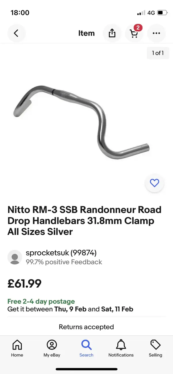

They actually look very nice - @KermitGKona88 linked his Mercian above with them. There are bars like this which are less perverse and more vanilla
I think I’ll try the short stem first and also some shorter reach bars like the Cinelli - but these things are expensive - the bike cost me £160 so these for example are more than a 1/3 the cost !!!
