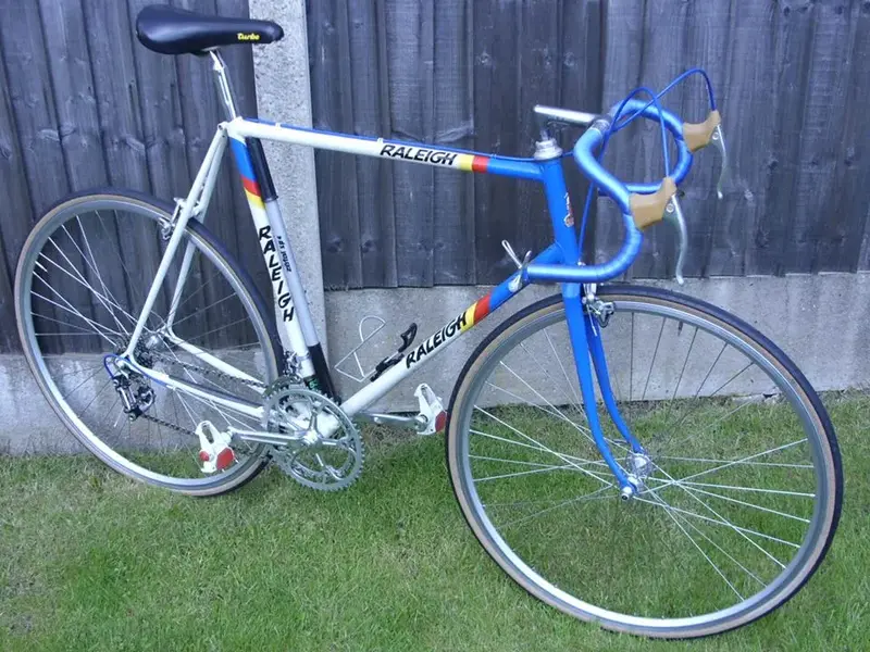

This type mate! Had it from brand new back in the 80's, holds very dear to my heart this machine does.

I'm going to have another look at the Corsa tomorrow, as this has got me thinking now!
Nice bike Ian, and you say ur stripes are painted on ? If you guys can double check that would be great.
As I say all the raleighs I have done (inc a SBU one) up to now have the decals on top the clear even if is just the word Raleigh. The ones I can see doing a goodle image search look the same to, blue painted and stripes are decals (hard to tell on some thou, so could be painted). Then the Raleigh words stuck over the top.
if you can check and see if there is a edge to either the stripes or words that would be great.

The stripes on my Team Corsa are definitely not painted:
They are, however, like waterslide transfers rather than decals/stickers (i.e. you cannot feel the edges, and they are not printed onto one piece of clear film)

and looking at my Corsa, these decals are applied after clear coat, hence the 'chip' on the red on my first posted picture.
If you can get your painter to finish it with a nice clean blue to white line, you should be able to get away with one set of red/yellow stripes. (if you look closely at any Raleigh bikes with this scheme you can see a slight bit of bleed from the blue when the red is applied over the top)
Also, note on my second posted pic how far the blue actually is painted on the down tube, and that the red stripe covers quite a bit of it...
