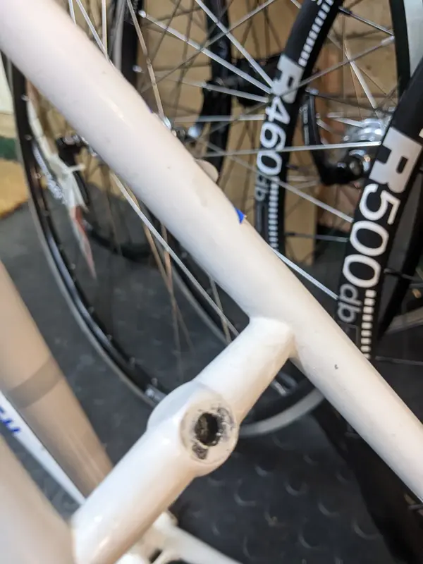

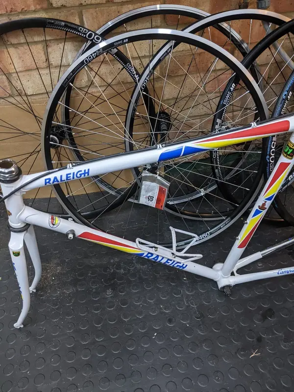

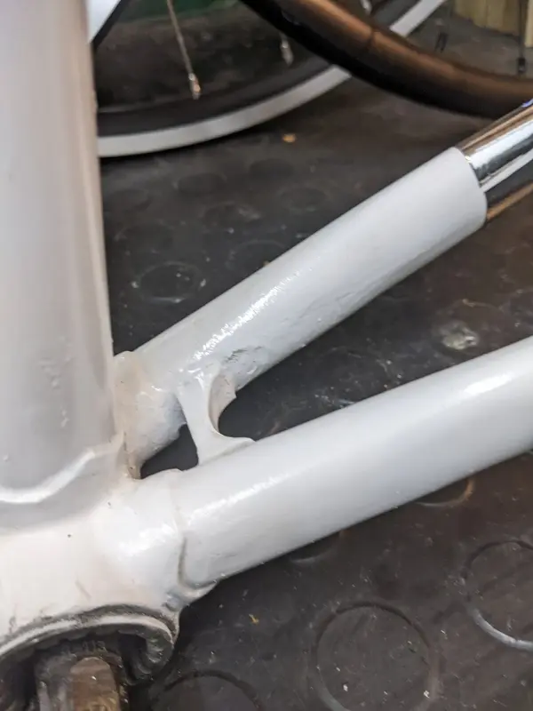

I just purchased a 'Raleigh' frame off ebay painted up in Castorama colours but sold as an 80s Veloce.
It certainly isn't a Veloce and having looked at some of the posts on here i'm now thinking that it's probably a Falcon not a Raleigh. I suspected this when I bought it but liked the look of it anyway...
It looks very similar to the post with a Falcon PMS picture. What should I look for to work out what it is?
I'm keen to get it back to it's original colour scheme or the old Falcon Blue. Under the very poor white paint job it has some black paint on the bottom bracket shell.
What looks like bad frame building in places is actually congealed paint, it is actually very well built. Thanks for any assistance!

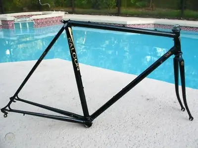

Also include some pictures of what I think it may be or have been originally...

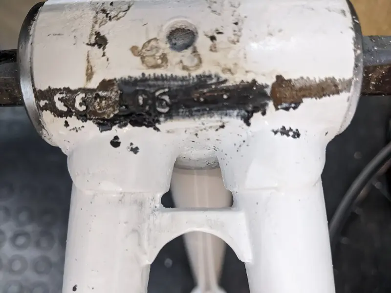

Difficult to read atm but i think it's 907423, nothing on the fork steerer.

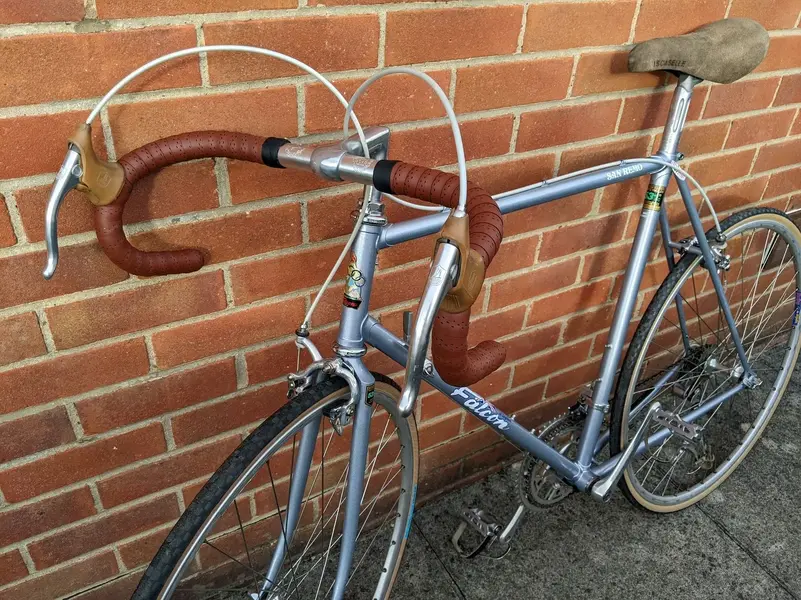

Found something very close but mine has a different chainstay bracket. Front forks and the pump 'nib' look the same.

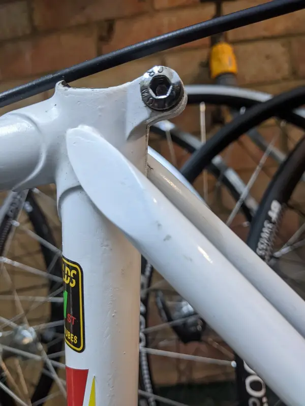

No W prefix or SB? If not, its not a Raleigh. Top eyes look wrong for Raleigh too.
No just a number and I can confirm the number as 907423. I also cleaned off the rear drop outs and they are the Gipemme of forged short variety.
