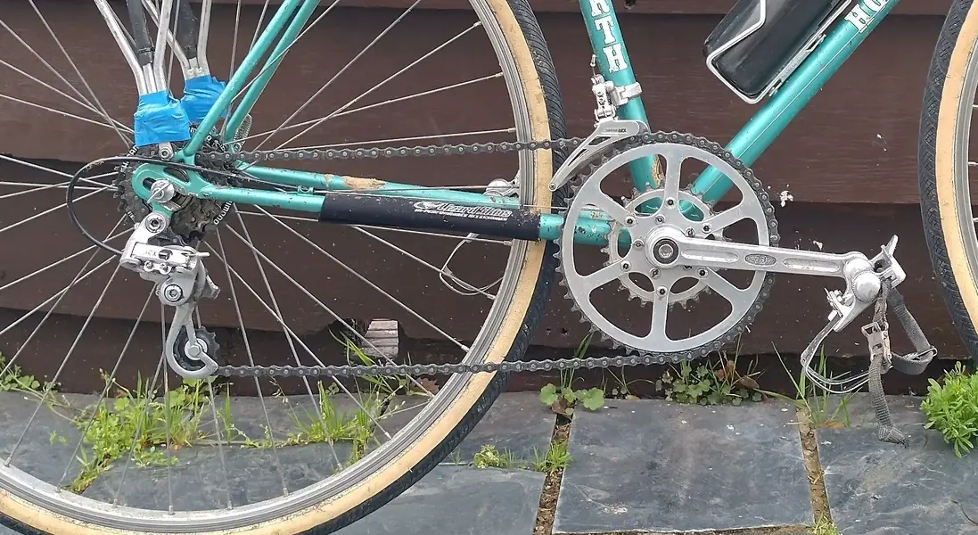

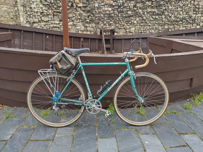

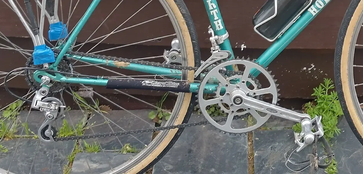

Hi all.
I'm hoping to get some advice on my planned drive chain upgrade on my 80s Equipe. I currently have a 14-24T rear freewheel and i'm planning to change this to a 13-32T SACHS Maillard to help on my longer tours across the hills of England.
As with most upgrades its a bit of a chain reaction, so to accommodate the larger freewheel I'm in need of a new rear derailleur.
I'm very keen to keep the vintage theme going with the bike, so i'm looking into mechs which are from the 80s/ early 90s.
I've come across the lush Suntour Cyclone which looks killer (although slightly pushing budget), or the Suntour VX, the Shimano 600 EX also fits the bill for largest tooth capacity.
Rear derailleurs with a capacity for a 32T freewheel seem to be a bit more difficult to come across on ebay, most of them are long cage varients which im not against, just would prefer regular sized cage. I'm wondering if any folk have some recommendations as to what they would reccomend for great shifting performance whilst keeping retro?

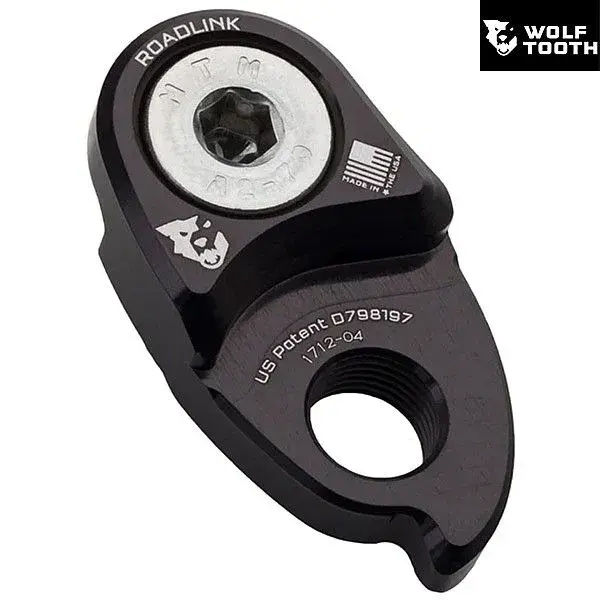

You could always try one of these if you want to stick with a normal rear mech
