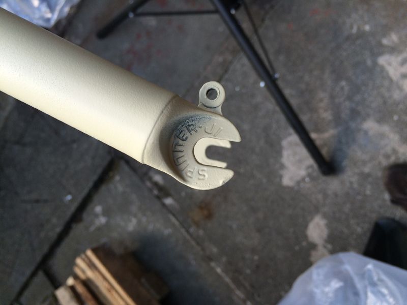

Took another look at the forks, the writing on the dropout is there, looks the same as shown in one-eyed jims picture tho I can't quite make out what it says.
So, p2 forks then? Interesting.
Serial number is well hidden, will try to make a rubbing!
Found a date stamp on the fork steerer, 1991.

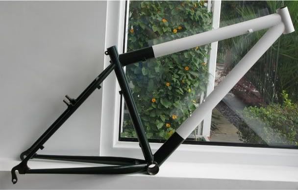

I think your frame is probably a 1992 Explosif that's been heavily reworked at some point: new cable routing and cable stops, smoothed-over welds and a respray.
A P2 fork with a '91 date stamp would fit a '92 model Kona. The tubing is Tange Prestige Concept. The dropouts and other details are all '92 Kona, bar the cable routing, which is (pretty clearly, I think) a later modification.
Look at the details of this larger frame, in particular the tubing and dropout shapes, the position and style of the rack eyes, and the way the tubing is crimped near the rear dropouts:
http://s121.photobucket.com/user/longun ... 4.jpg.html
It's not impossible your toptube's been replaced at some point, which would account for the (smooth) fillet-brazed toptube joints contrasting with the original plain weld of the downtube-headtube junction.
writing says.... SPINNER JI
deffo P2's
heres mine mid way through restoring ...
Canti bridge has a look of a zolatone era Marin. Rest of the bike doesn't. Could it be a frankenbike? Using frame parts from a number of donors? Would fit with a reworked Kona idea
