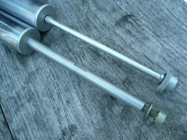

I am confused about this fork with the threaded dropout/bolt arrangement, can you post some pics. I will piccy a set of the other type of mounts for you.
Glue that was used back in the day is starting to go off a bit-hence some people are getting spinny dropouts[which I can rebond too ;)] The new stuff is better but due to the design/stresses involved cant guarantee that they wont ping off again :LOL:
Although RC300 says different :D ;)
Piccy showing the two types of elastomer skewer/carbon retaining bolts.
The lower rod type is the earlier one-the rod is screwed to the stanchion base plug and the bolt/washer holds the legs and topout on within the dropouts. The upper one is the later 'Damper screw' type mostly used in the '93 RC35 and '94 XCS.
These can be found in any combination in the RC35 forks though as a lot of them have been rebuilt/modified over the years.
