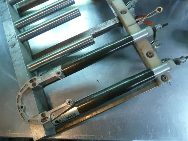

I will post a pic of the original bonding jig set up later.
:LOL: it used to go into an oven for full treatment!!
This is the last remaining RC35 bonding jig, all the others were skipped. It takes 3 forks after they were glued up and was then slid into an oven with about 8 other jigs to speed up the curing of the glue.
