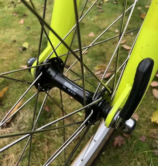

I haven't and I really should. It's currently stripped and polished. Stem and cranks have been powdercoated, bb bearings, elastomers, working hs33s, xt thumbs, bottle cage bolts sourced so well on its way.

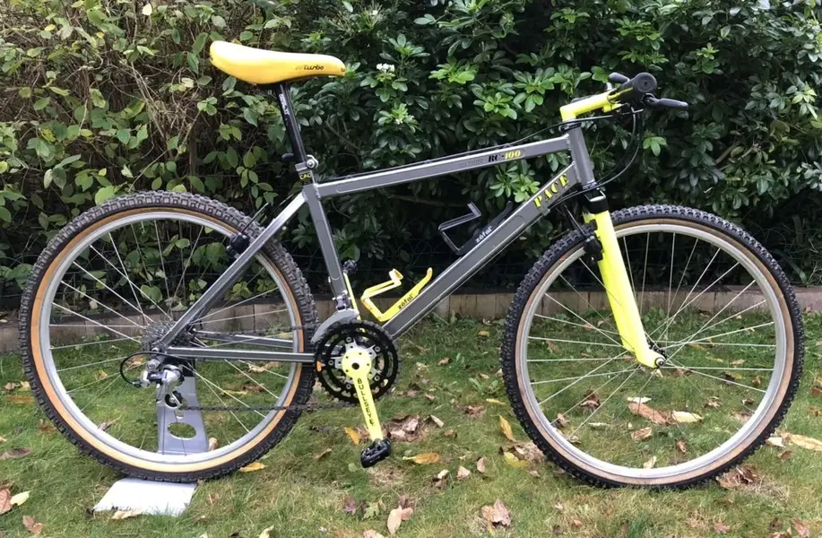

I think I can down tools on this one now :)
Last couple of changes made:

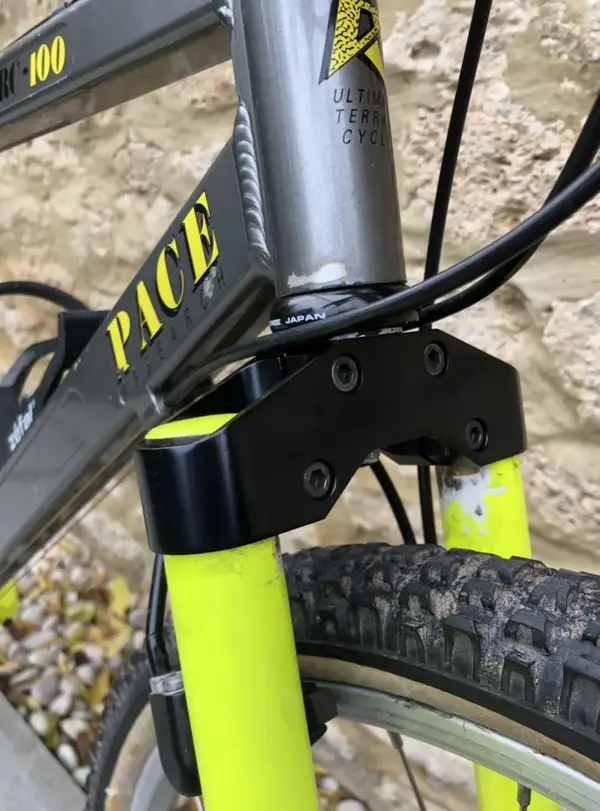

- Mavic front mech to replace the Campag road item
- Re-anodised black fork crown to replace the original drilled item :roll:
- XT seatpost QR to replace the Campag item

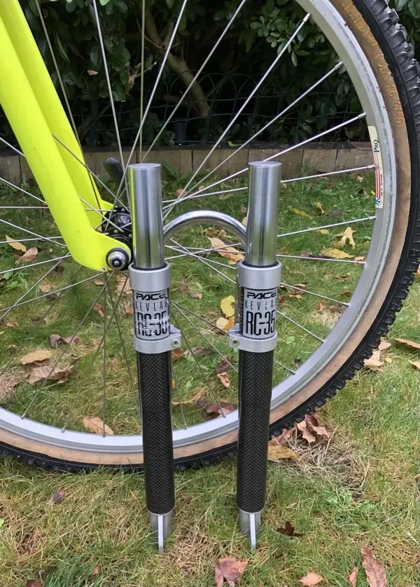

I’ve also got a pair of RC-35s complete with Magura mounts, so can switch to front suspension when required.
Pretty pleased with how it has turned out - although I must admit it’s a bit small for me! Here’s the spec as it stands :cool:
Frame: 17” Pace Research RC100 Aluminium
Fork: Pace RC30 with Reynolds 531 tubing
Headset: Dia-Compe Aheadset
Stem: Pace Research steerer/stem
Stem Cap: N/A
Handlebar: Renthal RC Sub130
Grips: Tioga Biogrips
Barends: N/A
Brakes: Magura Hydrostop
Brake Pads: Magura
Brake Cables: N/A
Cantilever cable hangers: N/A
Brake Levers: Magura Hydrostop
Shifters: Shimano Deore XT M732 Thumbshifters
Front Derailleur: Mavic
Rear Derailleur: Shimano M735 Deore XT short cage
Derailleur Cables: Shimano
Cassette: Shimano HG90 12-28t
Chain: Shimano
Cranks: Bullseye
Crank Bolts: N/A
Chainrings: Shimano Deore XT SG 48-36-24
Chainring bolts: Shimano Deore XT
Bottom Bracket: Bullseye
Pedals: Shimano PD-M737
Rims: Ritchey Vantage Pro 32H
Hubs: Shimano Deore XT M730, black
Hub Skewers: Shimano Deore XT
Nipples: ?
Spokes: ?
Tyres:
Front: Specialized Hardpack 1.5
Rear: Specialized Ground Control 1.95
Tubes: ?
Saddle: Turbo, yellow
Seatpost: Shimano Deore XT
Seatpost Binder: Shimano Deore XT
Weight: 10.98kg / 24.2lbs
BA00D324-925B-4D3E-8011-4C751BA59D9A.jpeg 72DEFF27-A207-4125-A400-CC5793A2AC2A.jpeg F933520D-95D8-45A8-AEF1-1269316BBD1C.jpeg
Great rescue. Looks the part.
My only comment - I can always recall having the wider tyre on the front, if running a mismatched pair.
