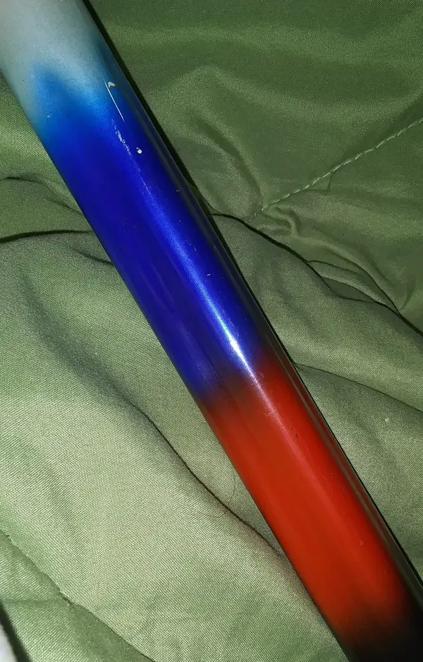

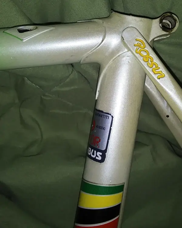

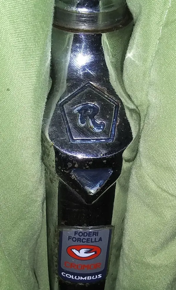

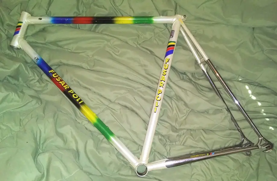

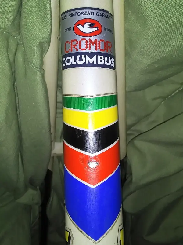

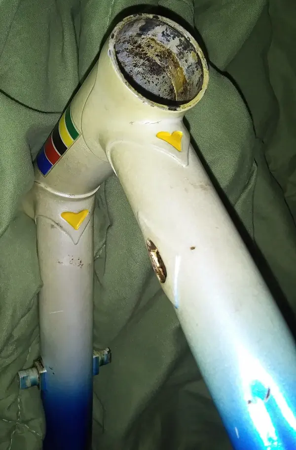

Here is another odd fluted tube frame. It is a Rossin built frame for Cicli Fusar Poli. Top and down tubes have 4 flutes in a GILCO style, but are Columbus "Cromor". Contacting Rossin has shed no light on the subject as to them modifying the tubes or having it done by Columbus.
Interesting frame; I think you should start a separate thread for it. I had never heard the name before, and I have never seen a cromor frame that was crimped/fluted in any fashion so I would say that it is fairly unique. I looked up the brand and apparently they are still in business. Maybe you can get some info from them.
