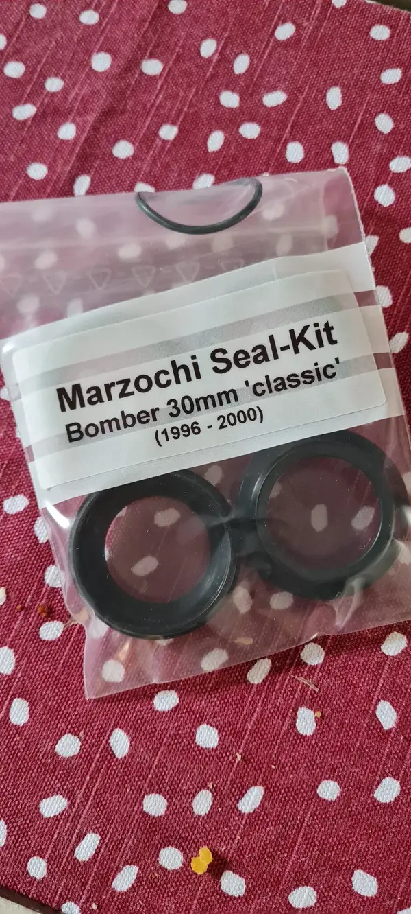

good to meet you fluffychicken! Enjoyed chatting and seeing your mancave. Lets hope those seals hurry up. Showing posted on Friday but still cant get live updates. Still the White Diamond High Polish arrived today so will keep me busy improving the already shiny finish on the frame and cranks.
