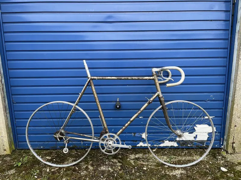

I’ve had a pretty serious session with the wire wool today. The TLDR is I’m probably ready to do some reassembly. Test fit time.
Naked:
Dressed:
Aluminium foil really wasn’t cutting through the oxidation so I swapped to wire wool. I had a big carrier bag full of it this morning and now I’ve only got a handful or so, but all the alloy parts are back to smooth alloy and ready to use. Example, mudguards:

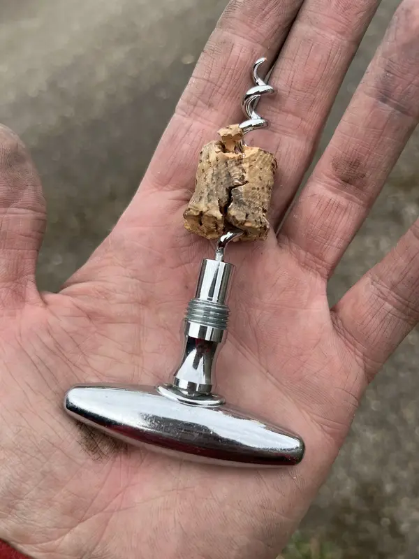

The stem and bars revealed something exciting. First I pulled the corks out:

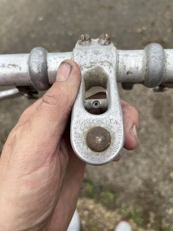

Then I hit the bars and stem with wire wool. I wouldn’t normally do this to alloy but there was so much dried shellac on them I pretty much used it to rub that off. The wire wool revealed this on the stem:
That looks a lot like an owner and their address stamped on.
M. Munita
9, Route De La Reine,
Boulogne,
Seine.

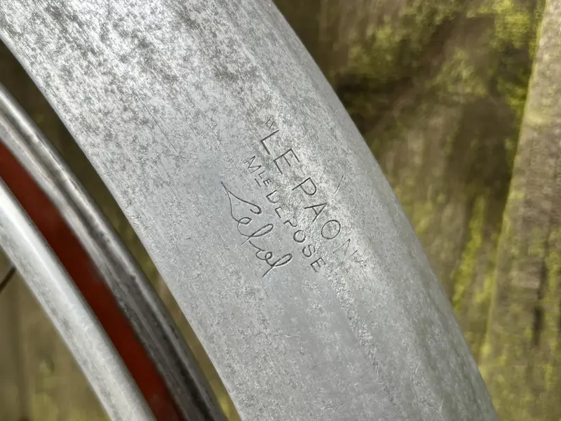

I found a make/model stamped on the mudguards:

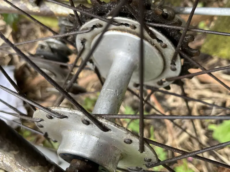

The hubs aren’t both the same but they are both Maxi Car. I’m pretty sure the rear one is original as it’s got the coloured anodised bearing covers that you see on René Herse bikes, but the front has steel ones.

Lefol mudguards are premium - as you would expect.

That stem is wonderful. If just oooozeess custom build for the customer who walked into RH and ordered it. 🥰
