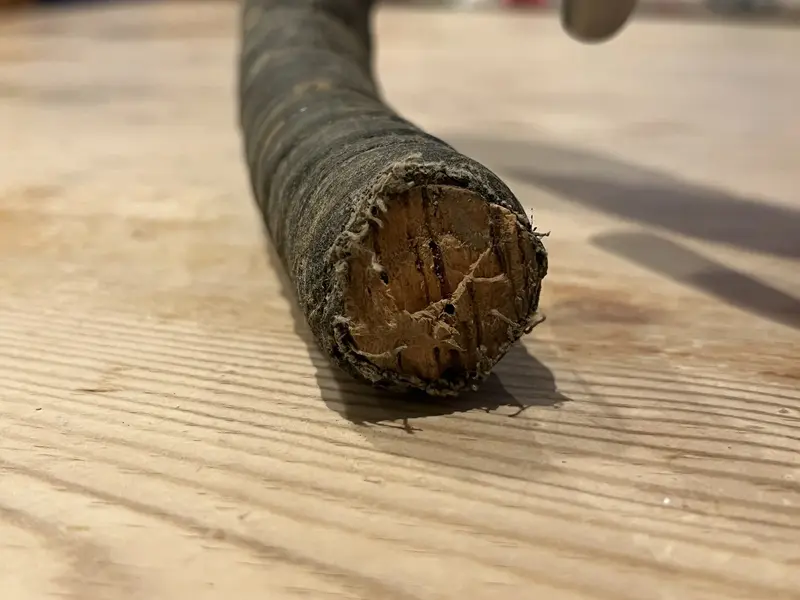

Bar plugs were cork on both sides:

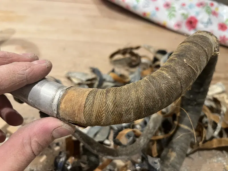

I just had to cut, hack and peel away at this side. Two more layers underneath the blue layer which resulted in this pile of mess:
On the other side I managed to separate the lower layers, but more importantly I managed to uncover a decent length of the bottom layer to show what could well be the original bar wrap:
It’s now a dark beige/brown, but it could well have been an off-white which has darkened down from the shellac and with time. You can kind of get an idea of the base colour on the back side. It was wrapped from the top of the bars down to the bottom. Stuck down with rosin or shellac because there’s a thick layer left on the bars in places. And I think the thing I found most cool was the little wrap of cotton around the top just to finish it off.
