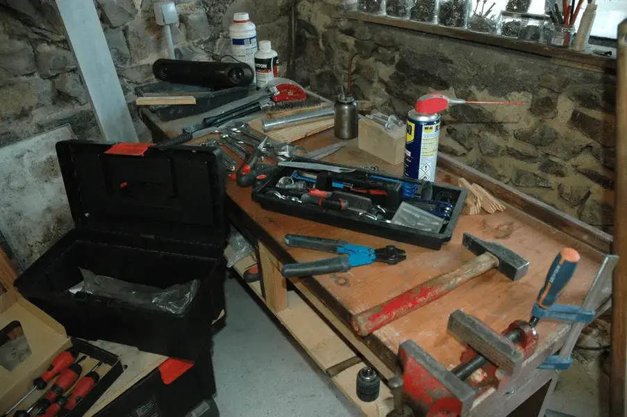

Only just got my shit together. New play list on the mp3 player, tools out and arranged, ancient Nikon D70 fully charged.
The dismantling plan is clear in my head, but I just heard the 19:00 bells so I'm forced to stop even before a spanner as got near it.

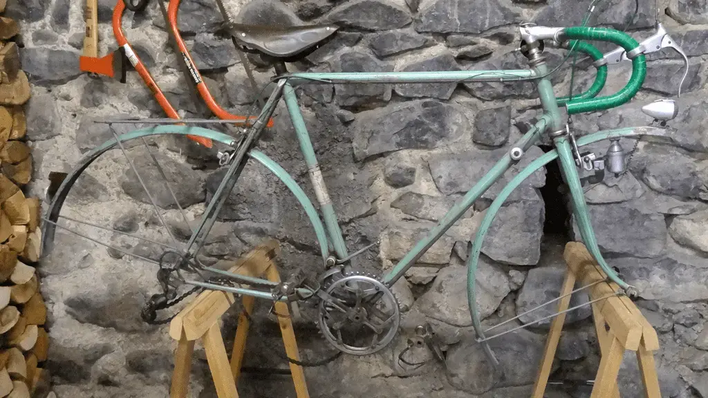

Dismantling plan of action was:
1) Unwire and take off Dynamo first. That way, any crimp damage to fork would be known early.
2) Rack off. Same again, any crimp damage to rear stays would be known early.
3) Mudguards. In France to be an astronaut, you need to demonstrate you can mount and unmount French mudgaurds.
4) Brakes. You have no choice. See (3). Nightmare. Not ashamed to say I struggled.
This evening, I got to this point with only one 1664. Going to eat and drink now and will sort through the pictures.
