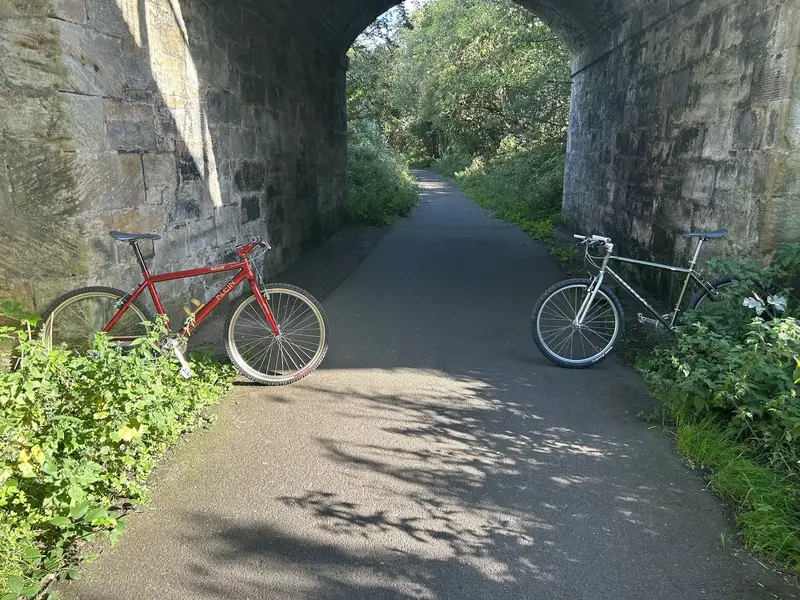

Thanks @Canuckbiker I tried hard to get some decent pics but that colour is a nightmare to photograph šŸ˜”. Either that or my phone camera is rubbish!
I was amazed at how she rides, I have another Klein (97 Attitude) with sus up front. Youā€™d think it would be better? Nope even with sus it feels harder. The Adroit rides more like my steel rigid Konas, only even better! Some sort of wizardry going on me thinks. Iā€™ve had/have many alloy frame bikes, none ride like this šŸ˜.

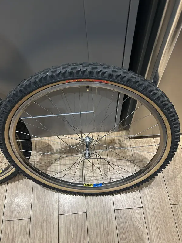

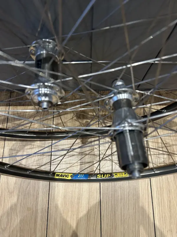

Itā€™s amazing what can be achieved when you get a day off! Managed to tidy up my Zaskar today and finally got the wheels sorted for the Klein. IMG_7557.jpeg IMG_7558.jpeg
Many thanks to @Lucidone for the wheelset and @mk one for the front hub. Only took a couple of hours today to swap out the front hub and fit the tyres/tubes. Iā€™ll get them fitted to the bike another day šŸ˜
