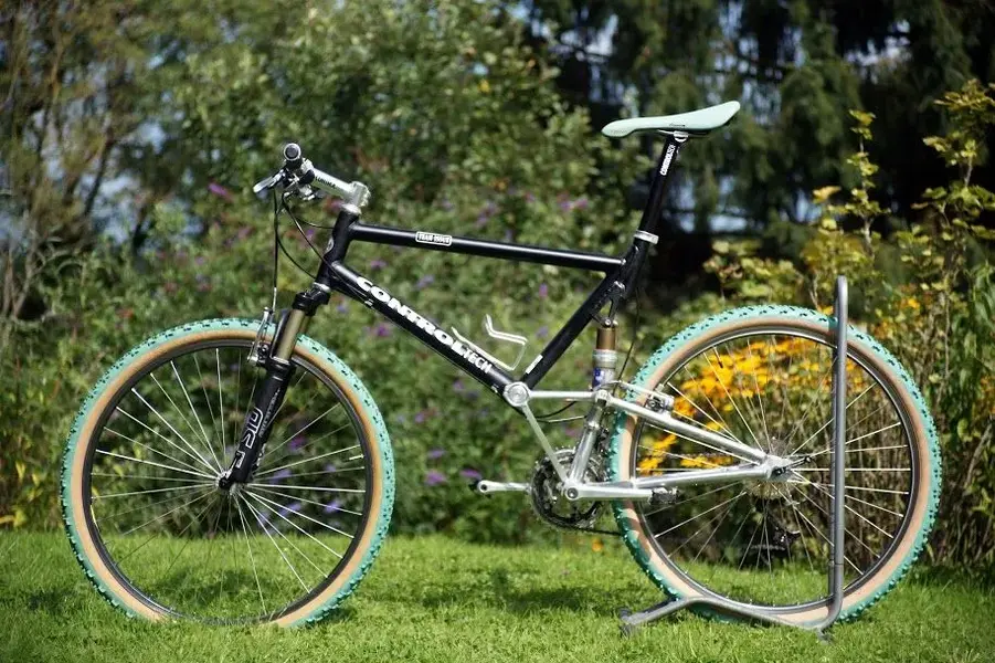

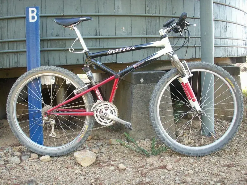

I'm surprised at how many versions of the "sweet spot" URT design thats out there
I've got a Schwinn build on the go but found at least two more brands using the same technology

You are right. I kind of count the Klein Mantra also into that group. Thow it's technically not the "sweet spot" but still very similar. I have one of those. I have been riding it last summer. And I think the Kleins perform better. But the Ibis looks cooler somehow.
