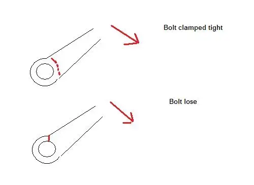

anyways, been thinking a bit about this.
bolts when done up correctly clamp the two pieces together and the friction between them is what holds the parts together, especially in side shear situation like here.
So if the bolt was tight, the stress would be above the bolt hole, as per red dotted line in top diagram.
If the bolt was lose, then force is "pivoting" around the bolt and will along the red line, which happens to be the thinnest part of the rotor.
It'd be interesting to see photos of the other failed rotors.
