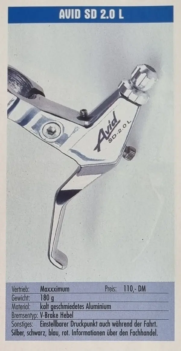

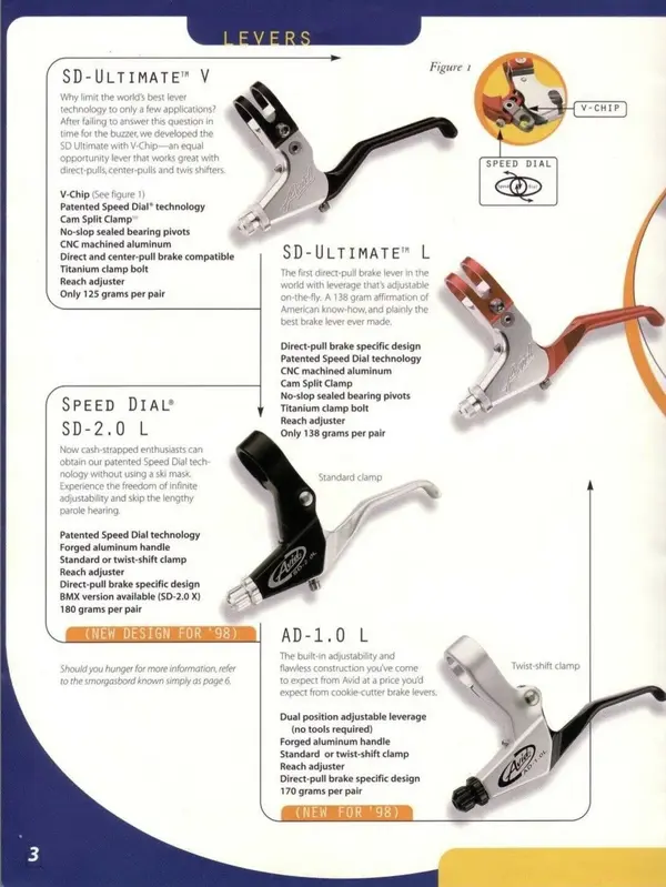

Hi, to my knowledge, only the "Ultimate" lever came designed for Cantilever brakes. That was roughly in 1995.
There was a later version for V-Brakes. They do have different so-called chips. Those are replaceable but hard to get (info and pictures to differentiate somewhere here in the forum).
Ordinary Speed Dial lever have been since ever designed for V-Brakes.
However as said from Hamster above already, in general due to the adjustable cable pull, most user are fine, so am I, when combining V-Brakes Speed Dial lever also with canti brakes but having the speed dial adjusted to reduce cable pull.
Edit: adding pictures
Avid Ultimate presentation on a show End of 1994
1998 borchures showing Ultimate with both variants (chips) and SD 1.0 and 2.0
Link to a picture of the V-Chip vs L(Cantilever)-Chip

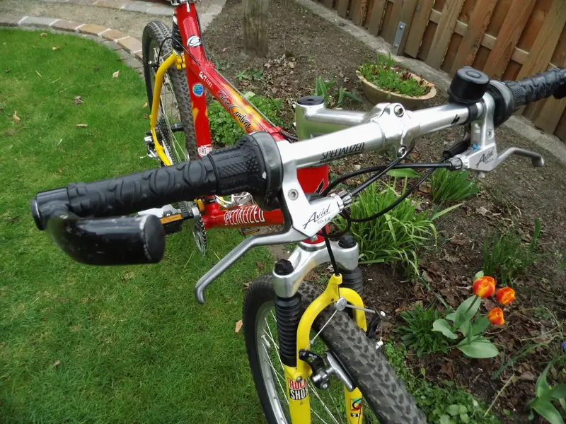

2005 brochures
Seconding what people have said above, I've used speed dials with disc, v, canti and side pull brakes by using the dial to adjust cable pull. Picked up another set recently from wiggle specifically because they're useable on everything.
