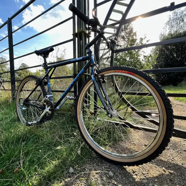

V brake vs Cantilever vs U brake? 90s GT
If you can't find a straddle cable that's long enough, you can use a standard brake cable, you will just be missing the extra large ferrule to help unhook it when you need to open the caliper
Yep, its an M733 (on both) as @slackboy mentioned. I was looking to restore mine to as original as possible, but if you are looking to modernise it (you mentioned elsewhere about fitting a 1by crankset) then you have a range of options. Not sure where you are based, but in the UK I find these guys quite good:
They sell straddle cables too.
As do these guys, who I've also used for various bits and pieces - very good prices:

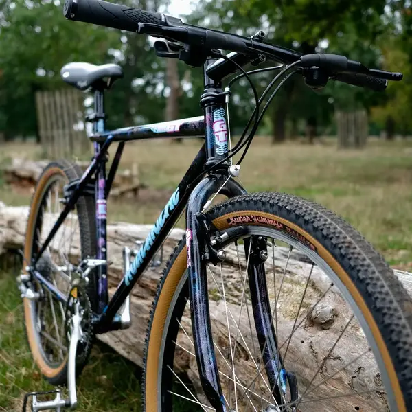

So is it a U brake on the back, but then a cantilever brake for the front?
Indeed it is. Post an advert in the wanted section as I’m sure there will be people with u brakes squirrelled away! You just missed out on some black XT cantilevers in the sale section that would have come with this bike.
