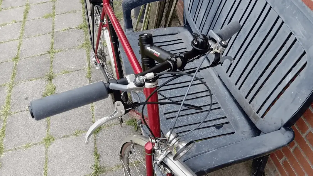

I have just swapped my (flawless) ergopower 9 speed shifters for some VO thumbies and barend shifters. I kept the Campagnolo RD so I went with friction shifting. I am surprised how quickly I took to it again. It just gives so much feel, it is uncanny. I have some Shimano RDs as well, so could go to index but I am loving this. So my question to you is: which do you prefer, friction or indexed shifting? Would you choose to go for friction even when you don't have to?
