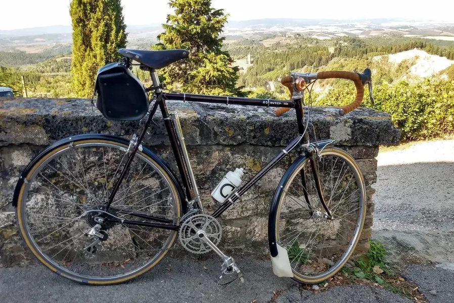

The first time I tried my hand at Shimergoing a bike was four years ago with this Austro-Daimler that had somehow found its way across the Atlantic. A really nice frame with a rather comfy sport touring geometry. But it originally had bar end shifters, which I didn't like much. So when I found a cheap pair of 9-speed Chorus brifters I put them on, added a triple chainset for good measure, and took it on a vacation trip to Italy.
As much as I like the elegance and simplicity of downtube shifters, for touring in the hills with the missus brifters are really nice to have. John is right in wanting to give them a try.
HI non-fixie. What are you using for a rear derailleur on that very nice bike?
Thanks. It is a nice bike. Credits go to the Austrian firm of Steyr-Daimler-Puch, who made these frames to the specifications of the US importer, Lifecycle Inc.
The derailleur is a Shimano RD-R552 GS. Basically a cheaper and somewhat heavier (more steel, less aluminium) copy of their Deore offerings. I needed a SIS-compatible derailleur, and this is what I had available in my bins at the time.
It doesn't matter much though, as all Simano SIS rear derailleurs (with the exception of certain Dura Ace variants) work to the same specifications.
When in doubt, check Velobase: Shimano rear derailleurs.
