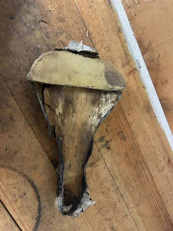

I’ve a very tatty Flite saddle which I’m considering recovering
To fit with a project it could go either white/cream or red.
Does anyone have a source or link to appropriate leather to use ? I assume it needs a bit of padding and to be stretchy.

if you are going with real leather then soak it for 24 hours before hand, you want 0.9 to 1.2mm thickness. if you go with something fake (preferable to be honest) then look for something with 4 way stretch like upholstery leatherette
the padding comes from the foam, don't get anything with padding stuck to it.
you can get upholstery leatherette on ebay for cheap, buy about twice what you think you'll need, although most places only sell by the metre anyway, this will give you enough to pull it about and stretch it. be aware that it will have a bias i.e. it will be stretchier in one direction than the other, from memory you want it to be stretchy across the saddle not along it.
you'll also want a bloody good stapler. :)
This what you need, https://www.ebay.co.uk/itm/225597193262

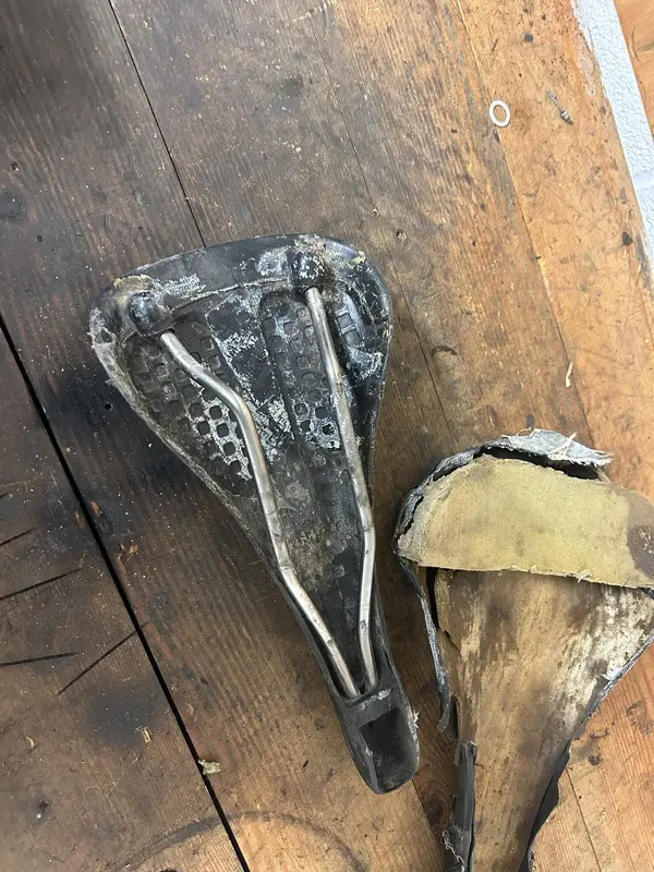

No need to pre treat as it already has enough stretch, use a contact adhesive such as evo-stik or Bostik. When removing the old cover peal it slowly as the adhesive can pull pieces of foam with it, I use a small hand held steamer when doing this to soften the adhesive & they can used to reshape compressed foam.
