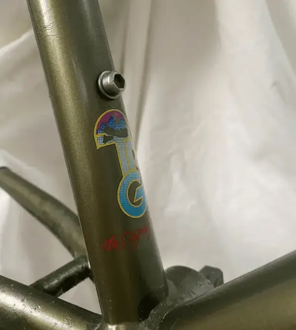

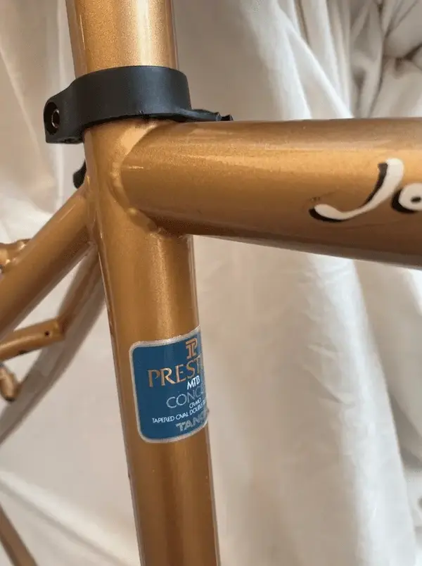

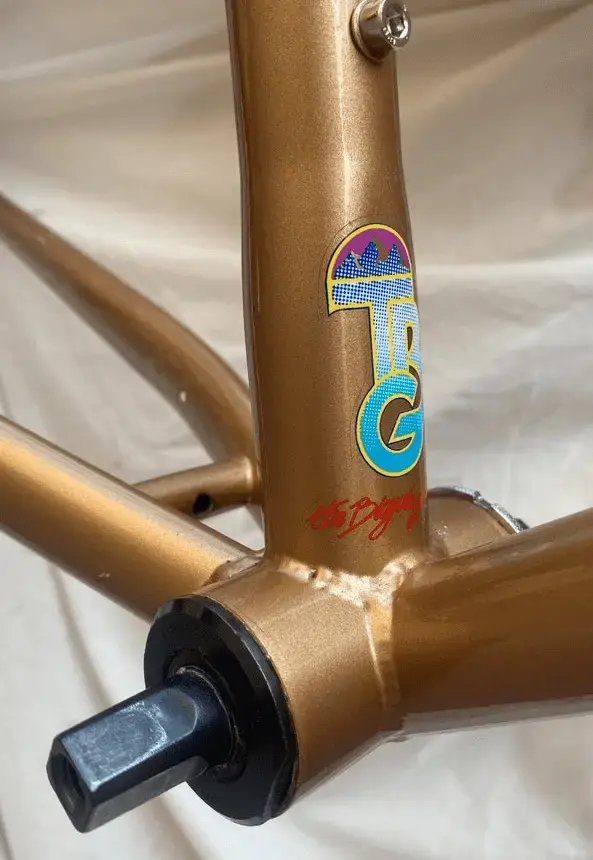

I like the bulge in the Prestige tubing. Very different to the more basic steel of the Cinder Cone:

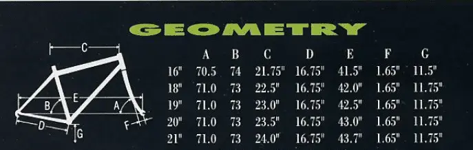

Here is the catalogue spec. I will be building the bike close to this, with a few period edits:

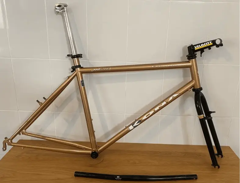

My frame is a 19 inch based on the cataloguie spec. It measures 20 inches from centre of BB to the top of the seat tube.
That looks to be very tidy, is it a 19”? Tuning in to see the progress.
Thanks. The wheelbase measures 42.5 inches; according to the catalogue that is the 19 inch frame. From centre of BB to top of seat tube is 20 inches though, so I don't know why Kona would classify this as a 19 inch frame.
I think on the early konas they measured from the top of the bb shell. Think it was 93/94 when they started measuring from the center. Of course I could just be making that up? But I’m sure I read it somewhere. Fingers crossed someone with more knowledge will clear things up.
Hang on, I liked the geometry post and didn’t even read it 😂. Must be old age creeping up on me 😬. Sorry.

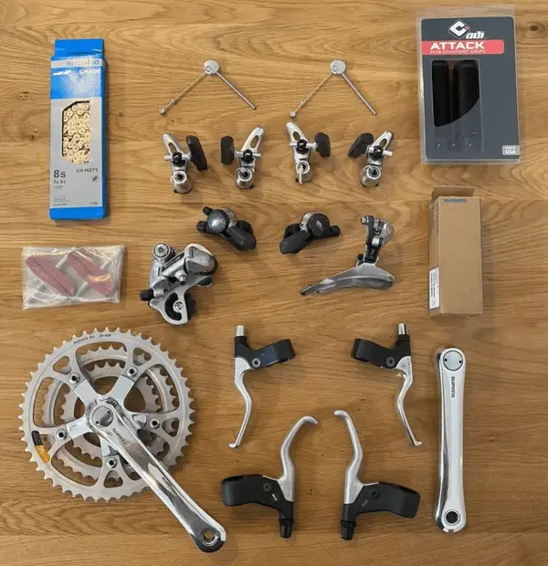

The component collecting begins:
The Retrobike forum has been a great source of parts for this build. @MatBH5 came up with a set of XT thumbshifters and @Walterscot supplied the XT front mech. I was really pleased to find a DX short arm rear mech (thanks @Antstark ) because this will go on my Cinder Cone, and the XT mech from the CC will go on the Explosif.
I was planning to fit Deore brake levers, but then @Tootyred had a sparkly set of Richey levers available which take preference. They are in better condition and also save a few grams:
For cantilevers I am going with XTR M900 as a really good set came up for a low price on the bay. I have these on my CC also.

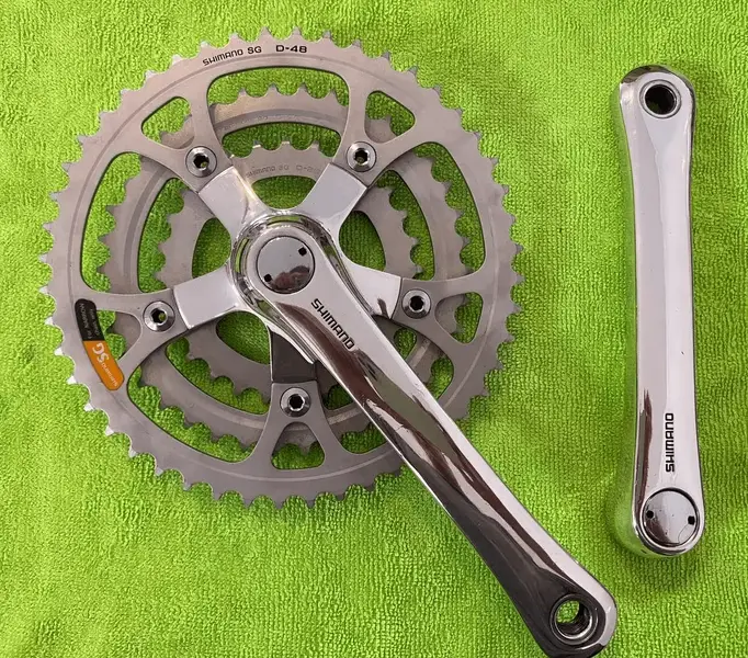

The 92 Explosif came with a DX crank as standard. I wanted an XT crank instead:

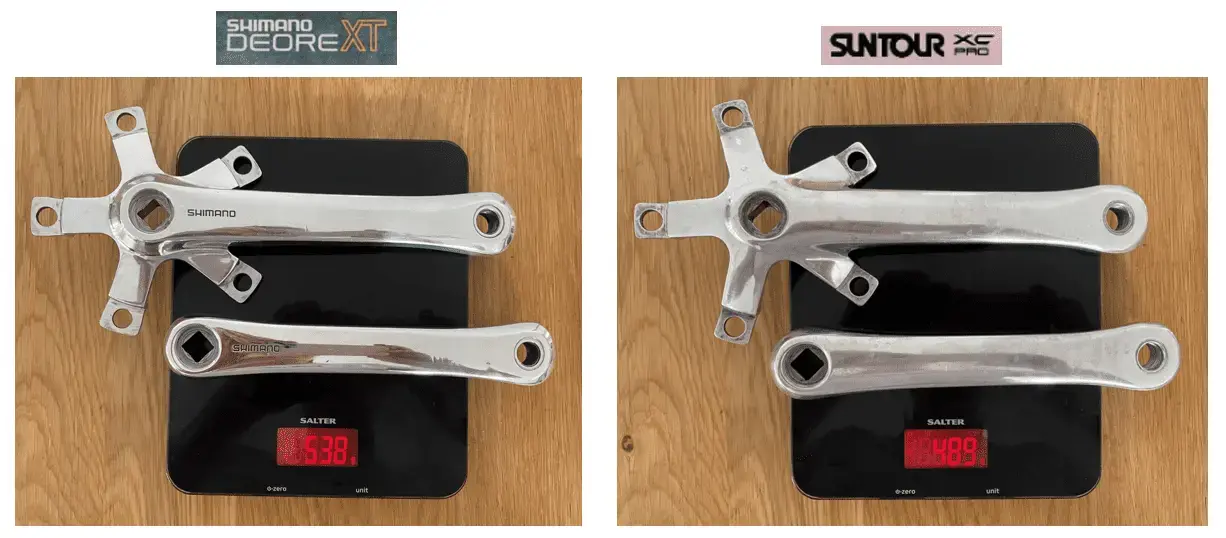

I have an XC Pro crank on my Cinder Cone, so I weighed them for comparison:

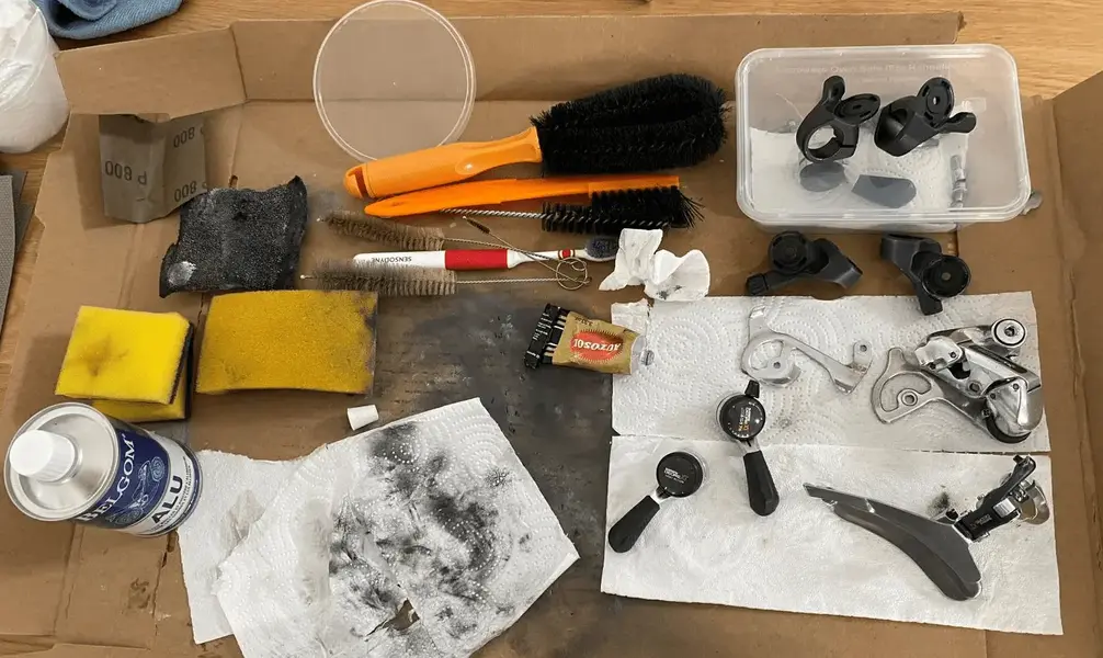

All the components have been hit with polish:
One of my favourite parts of the build is seeing the citrus cleaner doing its work:
