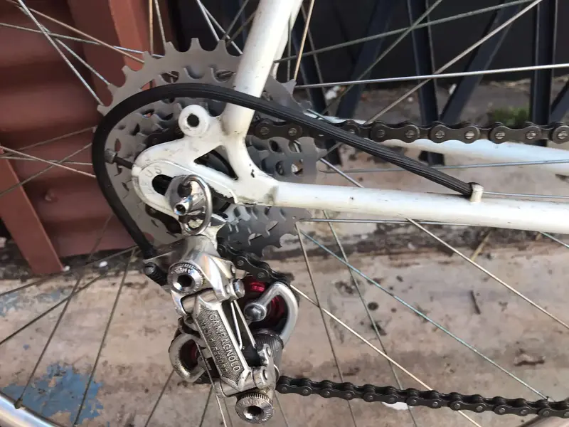

Believe it or not,. that is the original 1968 cable housing. That's the new SunTour 6 speed Ultra and the old Campi Nuovo Record Derailleur. So the question is would you do the cable housin different, maybe tape it to the tube so it comes out of the fitting straight, or make it shorter or (gasp) install a new one?

Will a ferrule on the outer help? Seem to remember the official campag one that was just silver exposed metal had a ferrule that fitted into the chainstay stop.
If you want to go to indexed shifting, I would strongly advise you to replace the shifter cable housing with modern compressionless material. And new stainless cables if you haven't got those already. The old stuff is too flexy for the kind of precision you need for an indexed system to properly work.

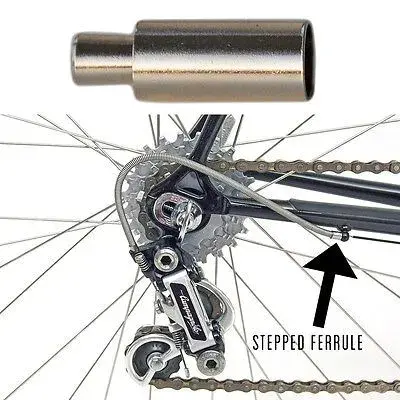

For the chainstay stop you'll need a stepped ferrule, like this:
+1 for cable and ferrule.

Spot on. Indexed cable outers are fundamentally different as the wires in the outer run lengthwise not spiral.
Removed all the old stuff and start again with new shifters, mechs and cabling.
It's a lot of faff, and to be honest friction works just as well if you are going to use downtube shifters.

The whole idea here was to get the shifters to the bar because I'm no longer comfortable leaning down to shift the friction downtube shifters. I had no idea the outers were different. the upper outers arrived with the shifters so I assume they afre ok although they appear to be spiral wound. The one at the rear-derialleur is very old, so replacing it makes sense. I asked it the new one should be shorter.

Using the old Nuovo Record rear derailleur despite Sheldon Brown's suggestion that it would work with the early Campi brifters might not be the best idea. He did say it didn't work all that well. My guess is that the spring on the old derailleur is much stronger than on the idexxed type. So I've gotta buy another reaer deraileur.
I also took a better look at the housing which came with my brifters and they are the brake type. The front works fine on my triple. So I'm going to figure out which housings fit either 4mm or 4.5mm and get the ferules and an adjuster for the rear derailleur.
Compressionless housing is typically not spiral-wound, so best to check. The time to replace them is now. ;)
I think you're OK, lengthwise. Compressionless housing is stiffer than what you've got now, so to make a nicely flowing bend I'd get a couple of inches extra, just to be sure.
