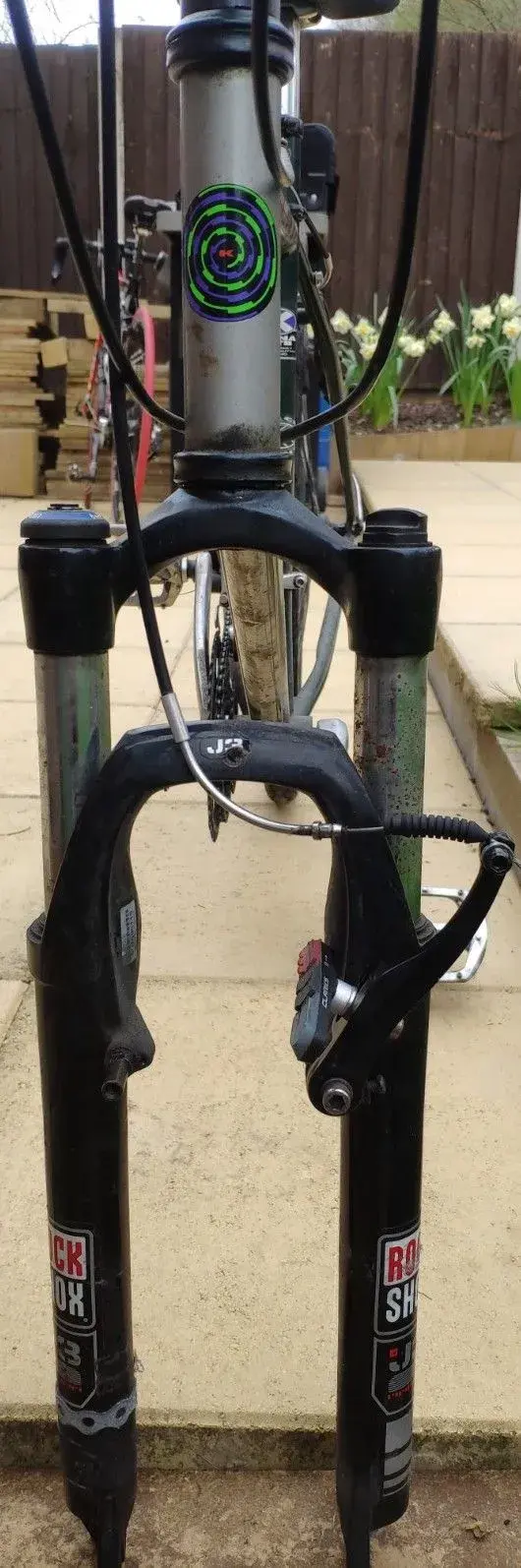

Grab a picture of the bike, we always need pictures :)
Might be after the forks steerer you have..
Pics attached. These are obviously non-threaded.
Ideally I'd just want to swap them out for rigid non-threaded, but I can't seem to find what I'm looking for (1 1/8th non-threaded, rigid), or maybe I'm looking for the wrong thing.

No, so much any more. It was for some 20 odd years.
Just check it's not tapered.
Or put a wanted up.
Length A2C (axle to crown) will want to be >410 (mod 90s) to 425 I would say. (late 90s length)
Late 90s fork where about 433 (70mm Bombers) but you have sag.
That looks to be a 1993 frame.
Adding to what F.C. has advised; the 1993 Cinder Cone is Pre-Suspension corrected geometry. A Threadless Rigid Fork with a shorter Crown to Axle and Canti Bosses will be somewhat trickier to locate.
The bike was designed to give the correct Head Tube angle with a C-A of 390mm, which was the spec for the Project 2 that year - but it will be threaded. I believe that the Project 2 was not made in Threadless, 390mm, Canti. You could use a later pair of 410mm Suspension Corrected Project 2 forks that came in Threadless, but this will make the steering a little more sluggish - but no more labouring the the Rock Shox J3 currently on there.
Pip
Great info, thanks. I'm considering doing a drop bar gravel conversion on this, so sluggish steering wouldn't be such a bad thing. Definitely want rid of the J3s, they weight a ton!
I posted a wanted ad :)
