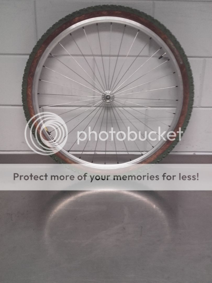

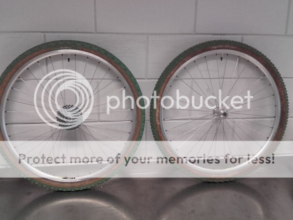

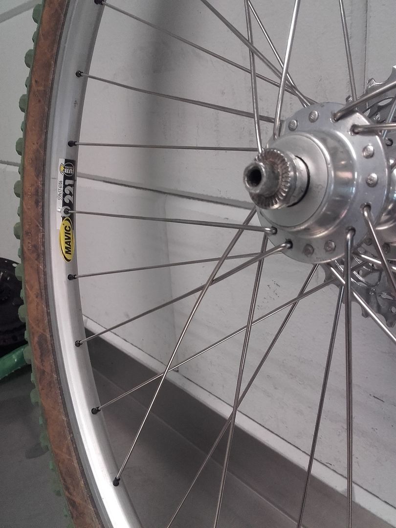

I made the wheelset today, it still needs some work: rear wheel spacing is 130 needs to be 135 and tyres need cleaning. Happy with the result so far. It's Hügi Union hubs, DT competition spokes with Black aluminum nipples on NOS Mavic 221 rims. Lacing on the rear wheel is 2-cross lacing with paired spokes, 90's wheelsets need groovy lacing, but I hate doing twists.

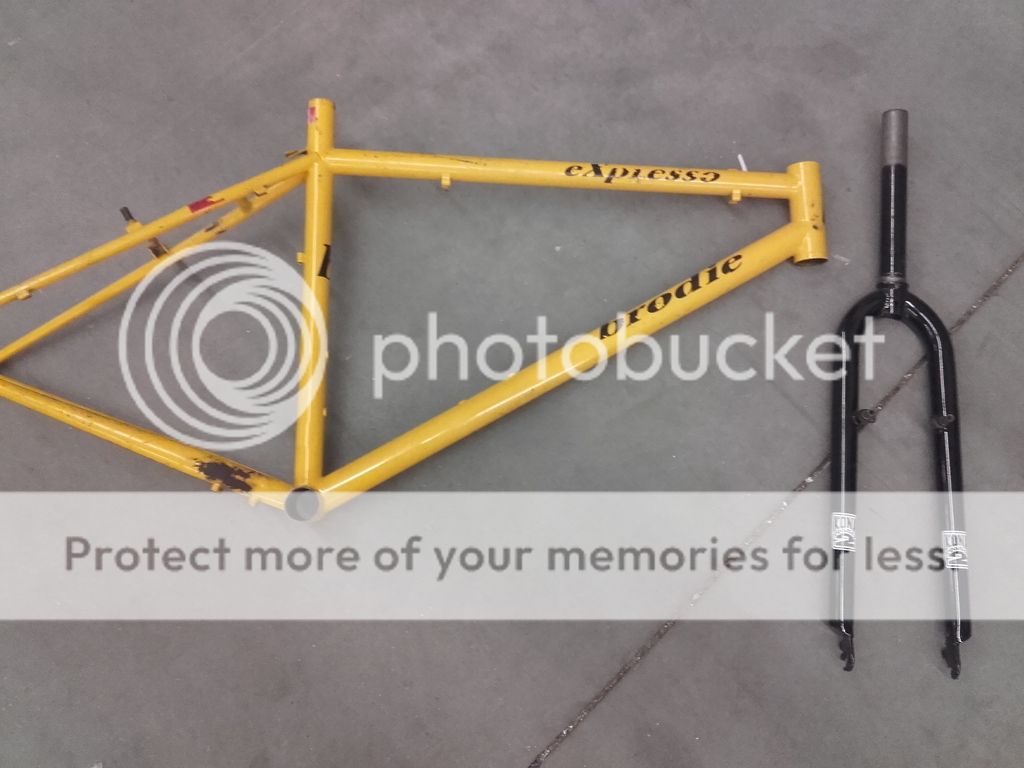

last picture in original yellow color, on it's way to chemical paint stripping, de-rusting and a new rust proof coating.

First step now is only removing paint, rust and giving it a rust proof KLA coating. Then I'll take it to a paint shop on the other side of the country :facepalm: . The shop doing the derusting cannot do the paint the way I want it, so they will just do the first steps. It will take a little longer but I want it done perfect. It's going to be a dark petrol, then most of the kit is going to be silver with some very subtle 3DV accents.

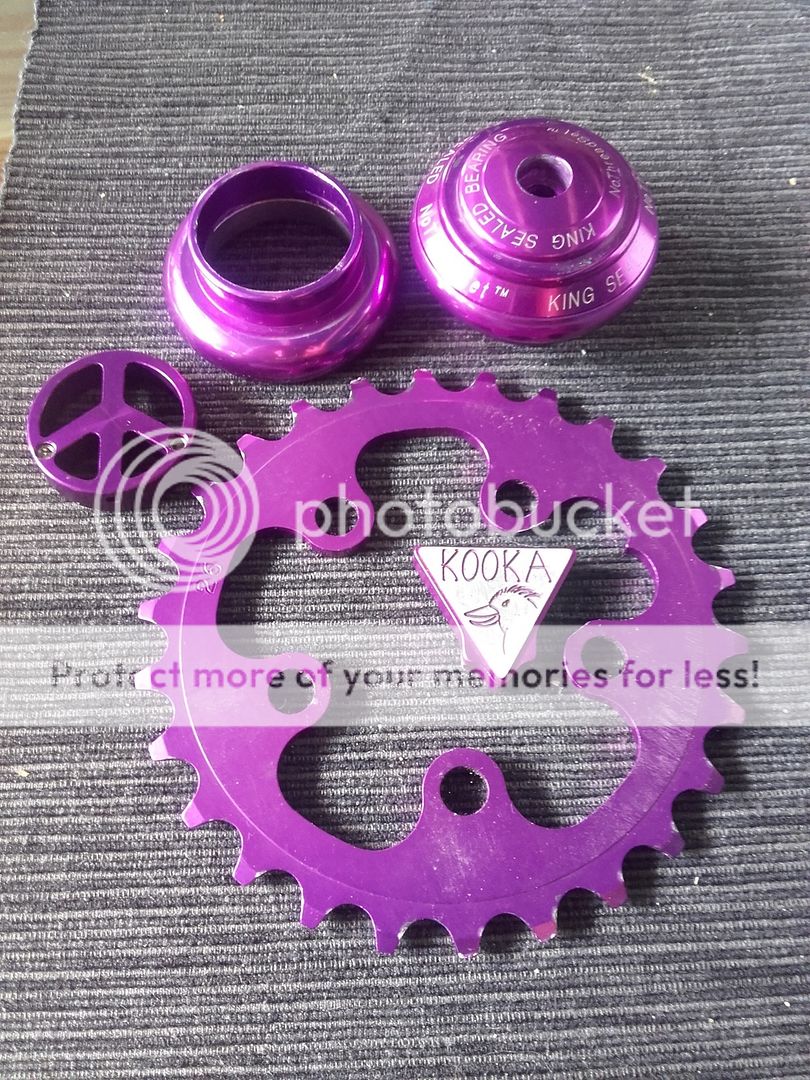

King nologo headset arrived this week, purple granny and cable hangers. More purple will come from a coghog (on its way) the skewers and seatclamp (need anodizing).

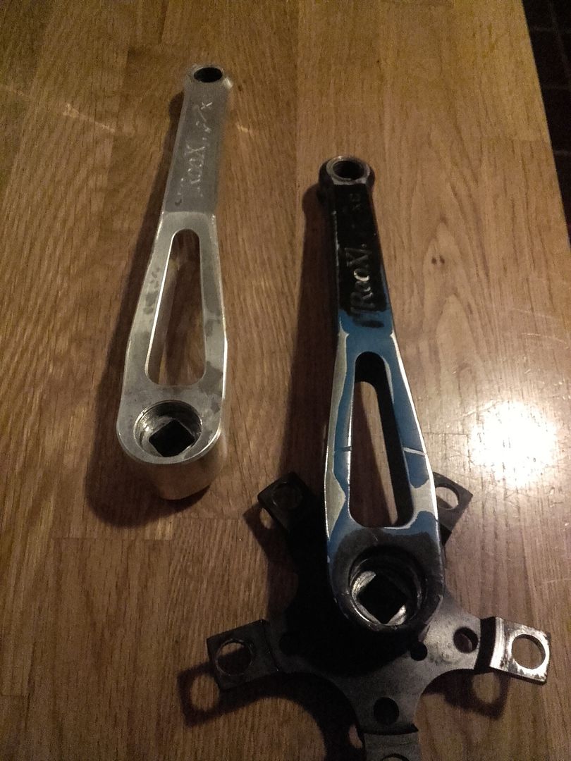

Crankset got a bit of TLC last week, I'm also going to have the arms silver anodized. Still needs some polishing and I'm going to work on some of the bigger scratches.
