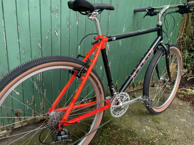

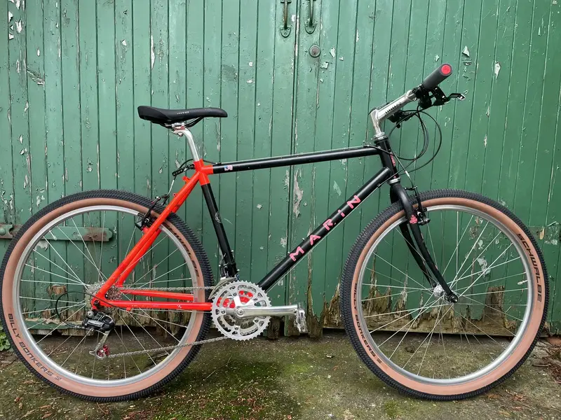

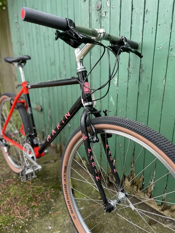

I finally got round to doing the eldridge grade that I initially started this thread about. Thanks for all your help, especially @Tootyred for sending me a nice headset and giving much needed advice! The bike is for my friend who is moving to Switzerland and wanted something to ride round the city, I’m pretty happy with how it turned out.
