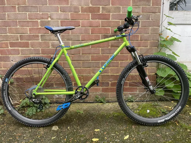

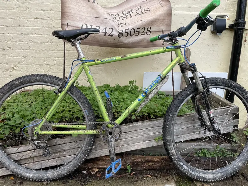

Finally finished this bike and took it out for its maiden voyage today. Started out as an Eldridge grade ended up an orange clockwork 😆 . Thanks for all your help , I learnt a lot, hopefully the next one won’t be such a struggle! Pretty happy with the build only thing I think I’m going to change is the forks for something slightly shorter , I bought a 1995 Eldridge grade with 2001 marzocchi bombers fitted for £40 today so as long as they work ok I’ll probably put those on . Here’s some pictures before and at the half way pub stop
