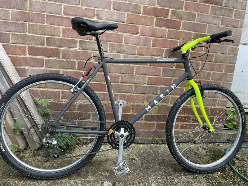

Hi, long time lurker/reader , first time poster, so please forgive me if this is in the wrong section of the forum or any other faux pas I’m committing! I started tinkering with a 1992 Marin bear valley during the first lockdown, that got me hooked and I bought a slightly worse for wear 1991 palisades to overhaul shortly afterwards, re sprayed the forks and bars revamped it a bit back to working order. I then bought a semi dismantled 1992 Eldridge grade at about the same time and I’ve only just got round to having a go at doing it up . My idea is to use the frame but modernise it , put suspension forks on and make it 1x drivetrain ideally. I’m realising it’s not as simple as what I’ve done previously. Would more modern 26inch forks be the wrong geometry for the frame? The bottom bracket that came out of it was a shimano BB-UN53 68 1.37 x 24. I’m unsure as to which of these numbers Is going to help me to get a new one? And lastly (sorry for the very long post haha) I’ve bought a 26inch wheel that will fit up to a 10 speed casette, with the idea of going 1x9 or 10. What do I need to consider when choosing a bottom bracket , crankset , cassette etc? If anyone could give any tips, would be much appreciated. Cheers

Hiya, I did a Marin 1x11 for my brother a couple of years ago. Used the original cranks and a narrow-wide chainring. With the bottom bracket the 68mm is a key number, the other is the axle length. The main consideration with axle length is getting it so the cranks don’t catch the stays at the same time getting a chain line that is not too wonky when you move up and down the cassette. I’d get it built with the existing bottom bracket and see if that works, you can then work out if it needs to be narrower or wider.
Forks on a bike that age more modern suspension forks may make the geometry a bit weird as I don’t think they are suspension corrected. Key number here is axle to crown measurement, likely to be lower than on modern forks to keep the geometry of an older frame in check.
Best to have a play around and you’ll get there!
Marins cope pretty well the 80mm travel forks due the seat tube angle and steep head.
You will raise the bb a bit, but again should be ok. The 92 frame is the same geometry as the slightly latter models, that came with an option to upgrade to a 80mm travel fork.
Have a play.....you will be fine...nice to see some unused kit back on the trails.

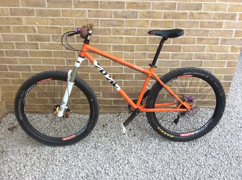

3 radical: get proper length rigid forks but get the widest rims you can in there and the biggest tyres. Run them tubeless. You’ll be amazed at what you can achieve with wider rims and bigger tyres. But you will need the clearance on the fork - this might mean running a modern fork (shock horror) with the right axle-crown length - but note that older Orange F2 forks have huge clearances - you can even run a modern carbon fork (eg Exotic) with a disc - then you can get hyper wide 26 inch rim on the front with a mahoosive tyre - run at low pressure and you will be astonished at the bump-eating performance. Fine for a trail bike…and no suspension dive to try to throw you over the front. People will laugh at the big tyre on the front and weeny skinny thing at the back. They will stop laughing when you trash them on both climbs and downhill. I have a COTIC SIMPLE (26inch wheels) with 36mm internal rims and 2.35 tyres. They are big. And absorb loads. Run 2,35 at the front on a wide rim and 2,10 at the rear on a narrow rim to get the clearances through the chainstays.

This a JMC replica - note the bars. Cheap and radical adjustment to your bike. Go wide.
This is the SIMPLE. It is bump eating when running a rigid fork - no need for a suspension fork most of the time. And yes that’s a 35mm stem.
