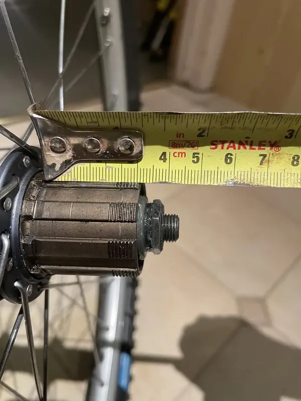

I’m afraid i need some advice again. Is there any reason why a 10 speed cassette won’t fit on a free hub body that it is (in theory) supposed to fit on. I read that you can put a 10 speed cassette on a body that previously had 8 or 9 speed because they are all the same size. Yet when i tried to put a ten speed shimano cassette on, the lock ring wouldn’t reach the thread…am I missing something obvious? It goes on ok without the smallest cog of the cassette
I don’t think fitting a 10 speed to an 8 speed is a given- it may depend on the make and age of the free hub - but I’m no expert
Yeah you may be right. Having measured it though I now think It’s actually just a 7 speed cassette body despite being sold as 8,9,10.
Thats a 30mm 6/7 speed body. Its quite old skool as it still has threads for uniglide cassettes.
