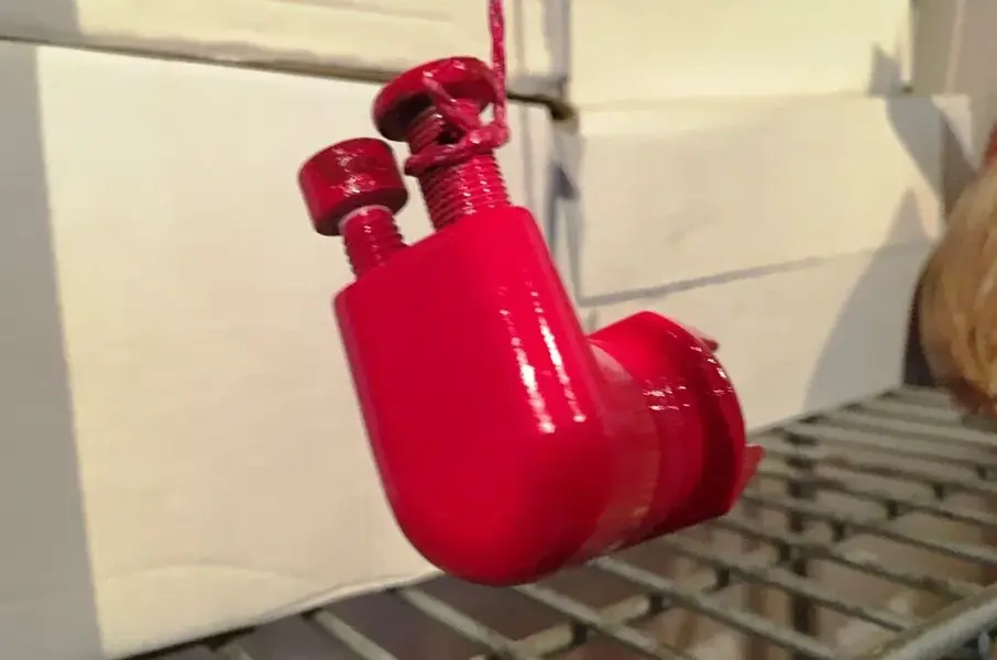

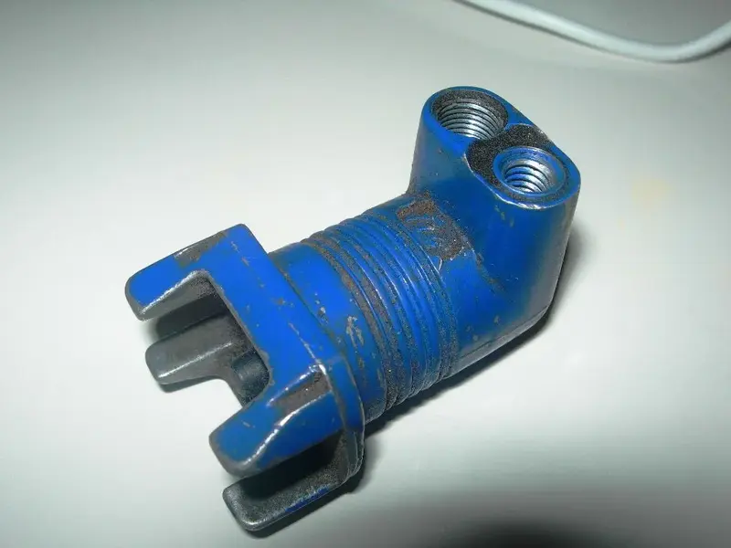

Operation Magura
After looking at the un natural bend in the front hydraulic line resulting from the change / swap of levers from UK to Euro style I wanted to move the line to the other side and get rid of the awkward kink as it bends back on itself
You can just about see the ungainly bend at the extreme top of this pic
After removing the line I thought it would be just a case of plumbing it into the other side, however that tuned out NOT to be the case, as one caliper/piston takes the main line and drilled for M8 in and an M6 for out - the other side has two M6 holes. :facepalm:
Since Magura aren't side specific I then decided to swap them over (Left to right), - Job done ! however where one had been taken On and Off in order to release the front wheel it was badly chipped on the rear and the white primer was showing through which wasn't noticeable until you turn them round and the back becomes the front - Thwarted once again :shock:
Having read a recent post on refurbing HS33's by Baznap I thought I'd have a go at it myself however I wasn't brave enough to cover mine with paint stripper,
so re-read the thread viewtopic.php?f=7&t=385879 and stuck a post in the wanted section for a donor and Foz came to my rescue with this :D
After finding a few old bolts to plug the holes and stop crud entering the hydraulic system I covered them in modern crappy paint stripper which I have to say easily took off the Blue
Should have taken a pic of it naked (but I didn't) the casting marks were to pronounced that I had to get a needle file and 800 grit carbide paper to the front face in order to get a smooth surface
Then white etch primer (no pics either :facepalm: )

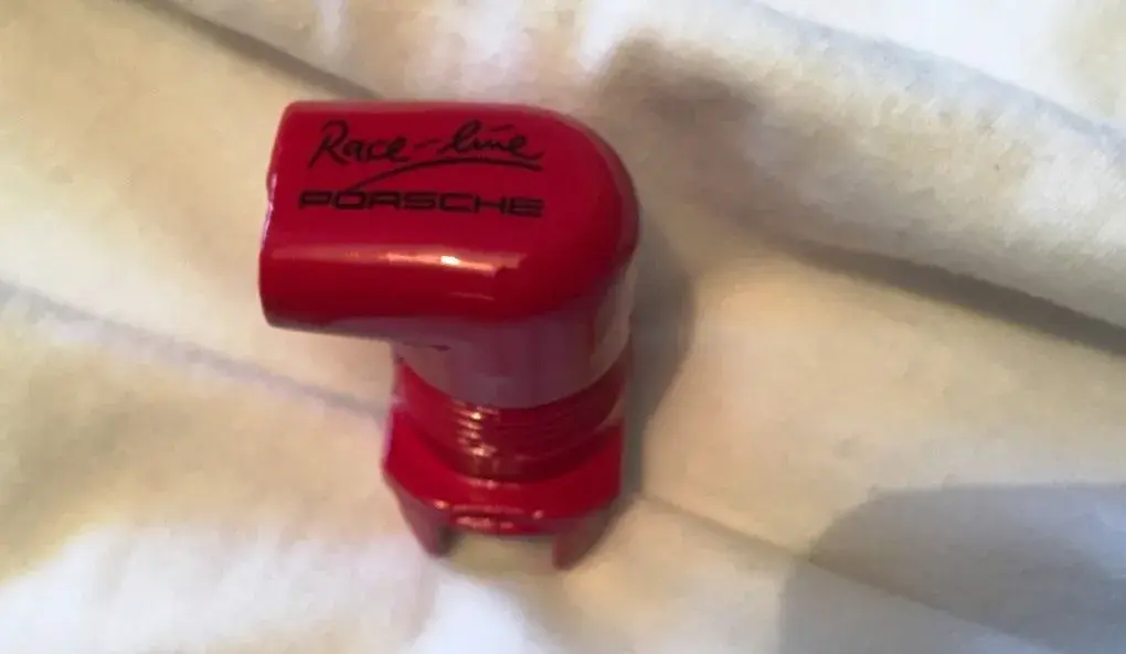

After a day to cure and a light key it was followed by a coat of Guards Red which I hoped would be as close to the original red on the frame as possible
and from a different angle with the M6 and M8 bolt - Pictures are crap as it kept swinging :roll:

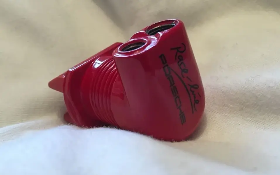

few days later having appled the waterslide graphics and allowed drying out before a coat of clear coat - here we are, just need to let it cure/harden now before I try and fit it.
how durable the finish is remains to be seen but I have used 2K clear coat just encase
Hopefully Mr Foz will let me have the other side with the M6/M6 drilling and I can have a matching pair that fit as Guards Red might match the frame but its not the same colour Magura painted theirs with so currently I have mis-matching sides :?
