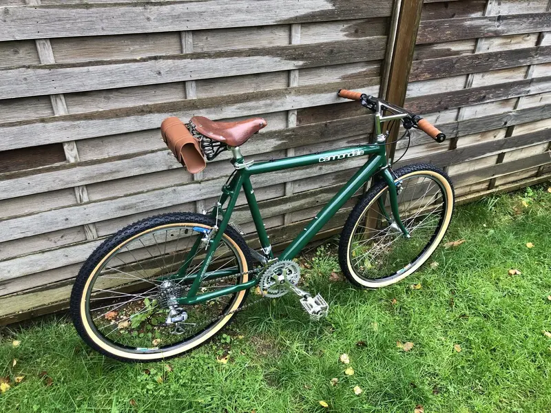

1990(?) Cannondale SM500 frame only build up.
Cool! What are the bulbous tyres in the mock-up photo? I like them as they don't seem to be emblazoned with logs (perhaps they are on the other side.....?)
Here you go - Billy Bonkers copies, they seem ok to me and no sidewall logos at all either side. 👍

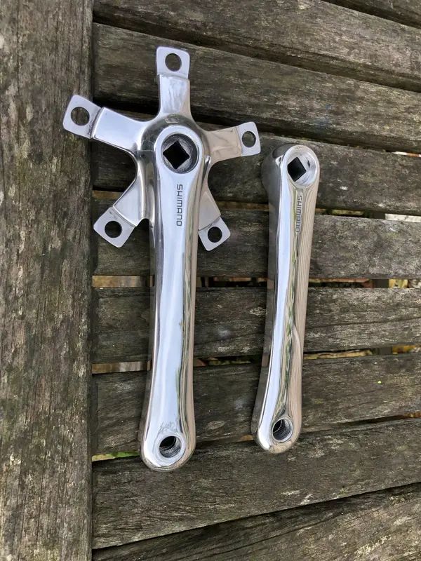

Didn’t get a great deal more done, I’ve stripped and sanded/polished the crankset for this one. It took ages!

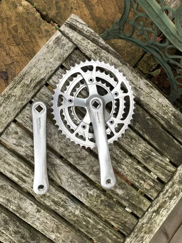

I bought the crankset off eBay a while back and the seller had been a bit ‘creative’ with the photos. When I received it it had serious wear to the arms caused by rubbing of some wide-ass trainers I guess when pedalling over the years. I had to angle grind and then file the arms flat before I could wet polish in 400/800/1200. Pic after grinding:

And after a couple hours wet sanding and then Autosol:
Looking nice now, I’m thinking of ditching the bio-pace rings for conventional round ones which I already have. Anyone have any thoughts? I’ve owned bikes with both types but think this bike will suit traditional round rings..
Always preferred round over oval myself. I fondly remember loving the "roundtech" name used to poke fun at Biopace but to each their own
I’ve never heard of ‘roundtech’ before - that made me chuckle! I have some mt60 cranks with some very tidy round rings which I think I’ll swap over and use on this. Should look classy.
Ask a subjective question and expect subjective answers! 😜 I love the look of Biopace, but also happy with round rings (Roundtech 🤣).
As you have decent Biopace rings to hand, I’d keep them as they’re period correct and would just be looking for a sticker for the outer ring for that finished look.
Good luck finding a Roundtech sticker if you go RRR (round ring route) 🤣😜

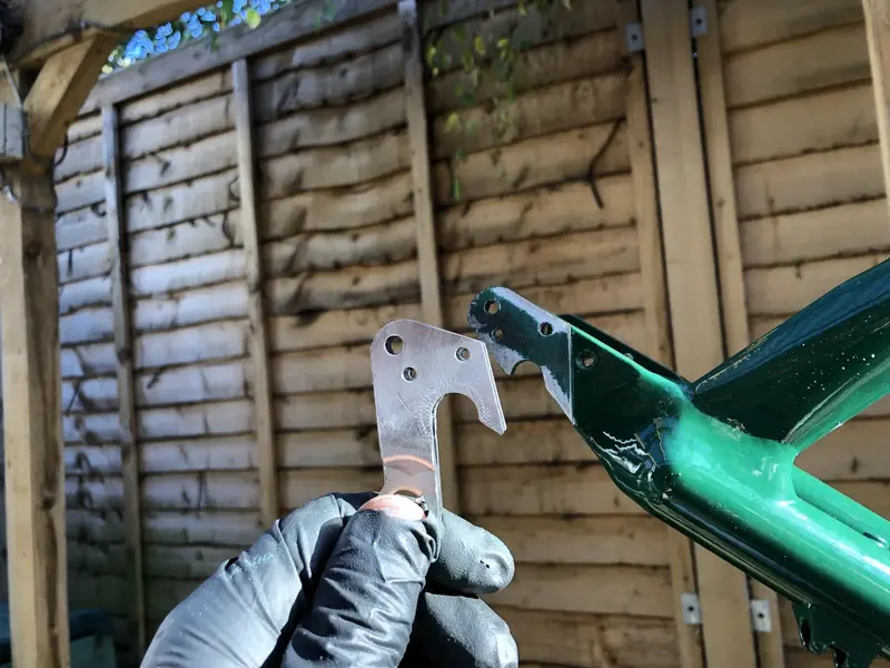

Did a double shift yesterday at work so got a day off today, managed to get a bit more done. Got the chainrings cleaned up and the cranks assembled. Found a nice 7 speed cassette in my spares so that went on the rear wheel. Had to file back the powdercoat on the frame to get the rear mech hanger fitted, that was a touch nerve-racking(!)

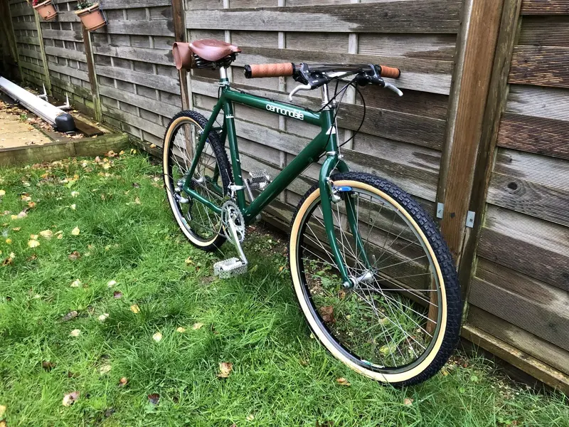

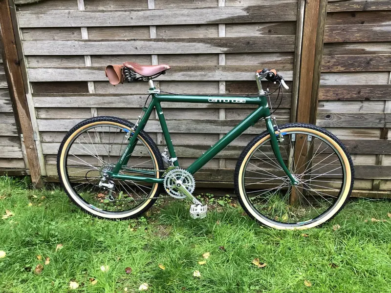

It’s finished! No pics of the bike yet as it was too dark and rainy, hopefully tomorrow..

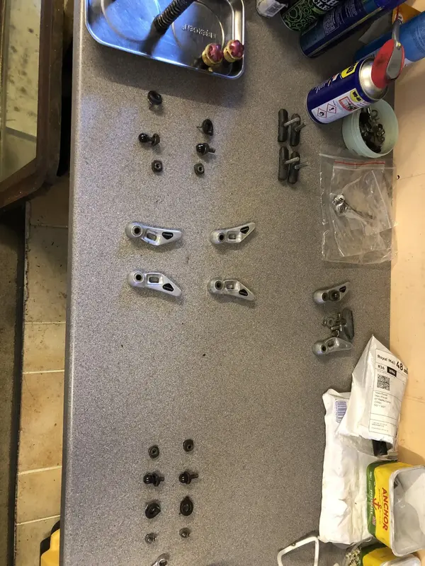

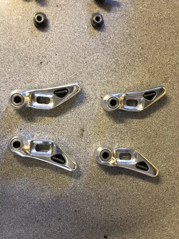

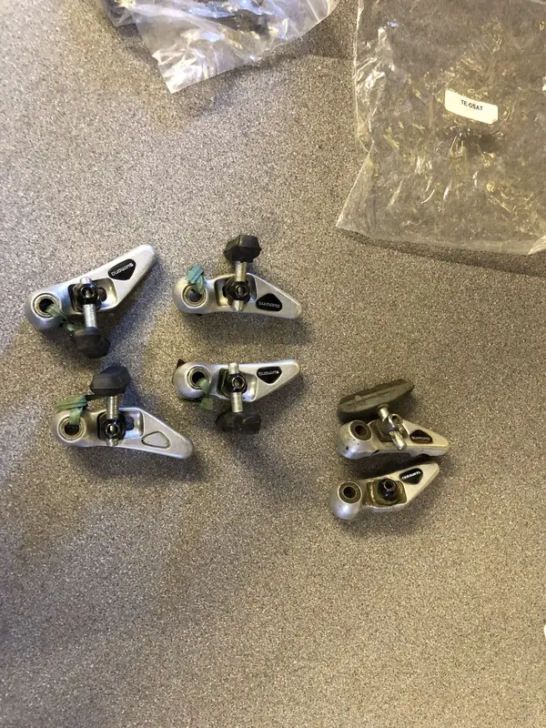

Last few updates, I’ve had a set of 734 canti’s for ages but one was missing the black triangle Shimano logo. Awhile back somebody offered up two slightly rough spare ones as karma (sorry - I forgot who it was) and I got those to make a decent set.
Stripped
Polished.

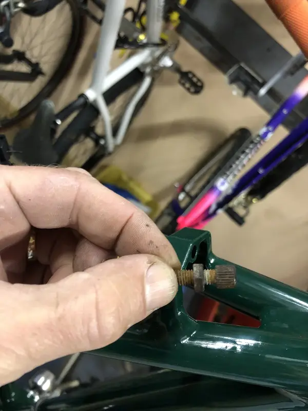

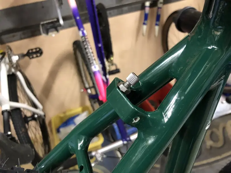

I painted the rivet heads black afterwards. Then I needed a barrel adjuster bolt for the rear brake bridge..
After a clean up.

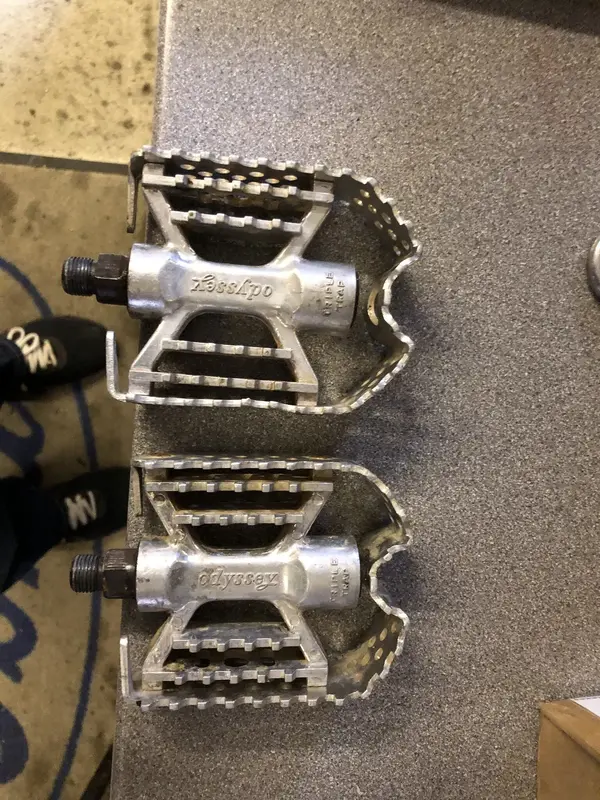

Cabled up after that and got it all dialled in, pics tomorrow.. Oh and big thanks to @scant for the great deal on the exact pedals I was hoping to find for this build, right place right time for these:
The dent in the pedal cage took about 2mins to straighten out, no dramas!
