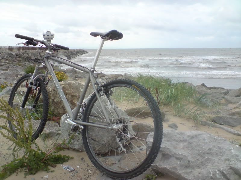

1996 Marin Team Titanium (started as a '99 Team Ti frame)
Just a little picture of its current set up. Just done 49 miles on her today and everything's sweet.
The 1.5 Continental tyres are a handful on dry sandy trails, but otherwise nice, fast and secure on the gravel and dirt. I can't believe how far I can lean over with them!
The logoless King headset is a fit-and-forget investment, along with the change in stem to a nice blasted Titanium one with Ti bolts and a Ti stem spacer. A few other Ti bolts have been placed around the bike too.
Bottom bracket bearings and a pedal stripdown are next.
