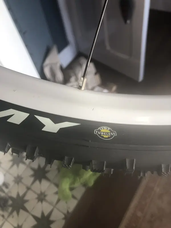

Hello Peachy. Are the tyres full on UST rather than 'tubeless ready? I tried once to get some UST Contis on those rims, it was like the rim was 26.5" and the tyre 25.5"! After breaking umpteen tyre levers and some choice language, I gave up and used some tubeless ready Schwalbes, problem solved! Stans invented the tubeless ready system and I don't think a UST bead plays well with Stans BST rim hook even if you manage to get a UST tyre on.

Ah... bugger... yes these are UST..so I guess it’s new tyres or new rims.... F9021480-D48D-43A4-9A56-29FF4F8FE9BE.jpeg

Its been quite a few years since i ran tubeless. DIdnt use to use sealant,, but used to run UST tyres/rims. As the tyres need to be a better fit, some are nigh on impossible to fit, most should still go on by hand though.
