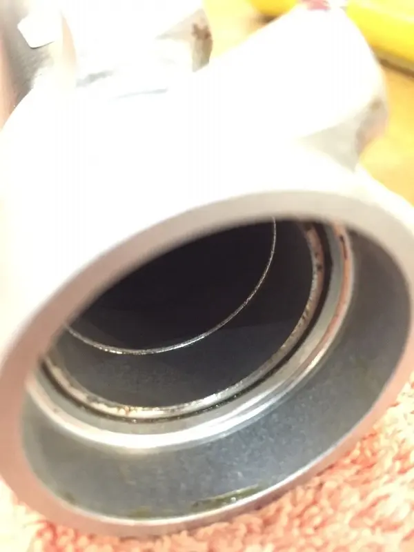

FSX forks... Nice work! Yup my CNC brace died many years ago. Swapped for Judy DH from that era which fits perfectly in place. I'm an old Rockshox Technician from that then. Fitted the longer travel kit (alu cartridge) and a neat trick is to put two bushing stacked at the upper fork legs to reduce flex. Did this a lot for our team members (see my photo)

Worry not Thias, the forks had a full strip down and rebuild... I have plenty of Rockshox spares from when I was a Rockshox mechanic. The cartridge has had the damping oil sorted, fresh seals and a nice supply of Judy butter applied to the stanchion tubes etc. They are running buttery smooth
