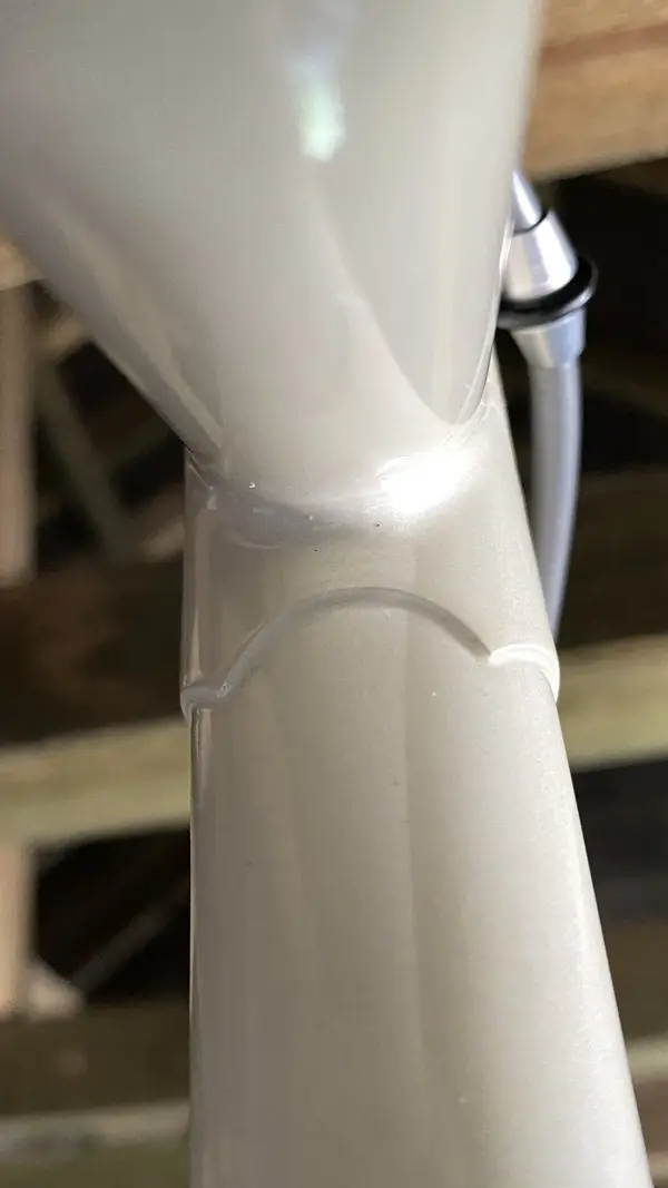

You can always tell if Winston Vaz built your frame as he added a signature feature on the seat tube reinforcement sleeve. He would cut a scallop into the back of it.
