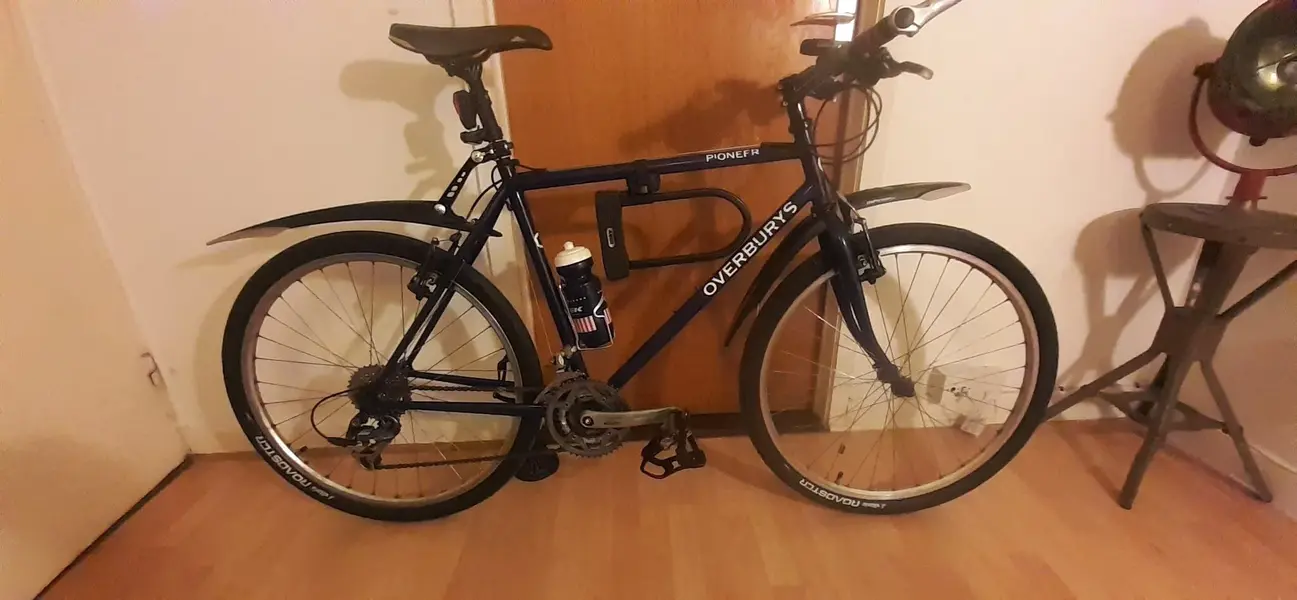

1989 Overbury's Pioneer 700c
I can confirm that this frame started life as a 26er, I found the traces of where the original brake bosses were situated on the seat stays...
It was very hard to see it, especially with mud guards and rack fitted and before the frame was cleaned. The fork shows no sign of any work, so that was originally made for a 700c wheel. There's no way of knowing whether or not this conversion was done before the bike was first sold, or if it was a later modification, or indeed where the work was done.
Anyone who knows about such things please feel free to shed some light as to the processes involved, it seems to be a very neat and tidy job,.
It's nice at least to know with some degree of certainty that this is/was originally a standard Pioneer, and as much as I'd love to know more about how, why and when the change was made, the mystery only adds to the bikes charm in my eyes.

Gave it a bit of a Spring upgrade taking it a couple of steps closer to its final form, focusing mainly on comfort.
New wider titanium handlebars and riser stem (in preparation for drop bars), my favourite Grab On foam grips, comfy old Turbo saddle and new tyres. I'm also trying to move it away from the 'Dennis the Menace' black and red theme, going for more of a red and silver with some tan.
These changes really transformed the quality of the ride, especially the tyres, which were expensive but I can see what the fuss is about and after a 10 mile ride this morning there's no trace of buyers remorse. Of course they aren't period correct, neither is the stem, however this is going to be my daily workhorse for at least the next couple of months and so it's much more about the ride than winning concourse events. Having said that if I find a nice period stem with the same rise and reach I'll swap it.
I also changed the cassette, the old one was beginning to show signs of age and a couple of the middle gears were slipping, the new one has very little wear and shifting is now crisp.
Next will be the crankset - I need 175's and have a couple to choose from, then finally drop bars and brakes which I'll do together.
